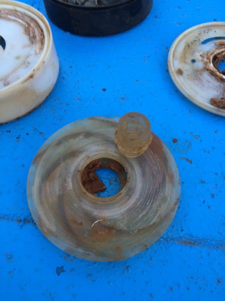

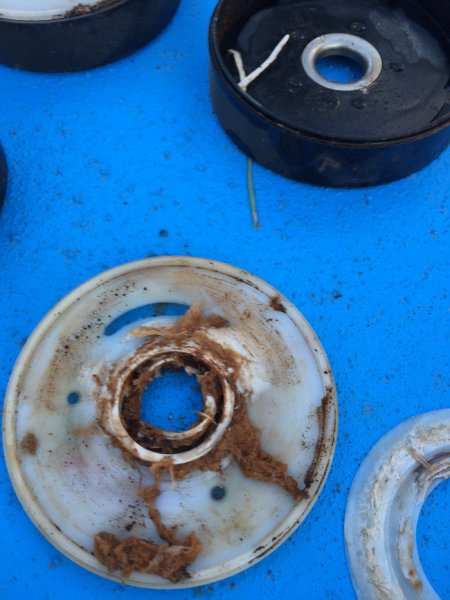

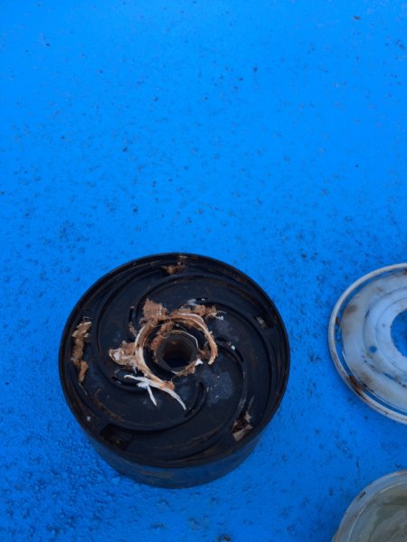

    Second one had issues immediately and self destructed... ***Stainless jacket with plastic impellers*** NEVER ALLOW ANYONE TO INSTALL JUNK LIKE THIS AT THESE DEPTHS.
    Current pump installed MARCH 2017 is a Grundfos all stainless unit.
    Cost twice what the plastic POS did.
    PIX of second pump destruction
    One impeller in the lower portion of the top stack broke the drive hub (Plastic ) and caused the impeller to float and block the water flow...starving the upper impellers and resulted in the destruction of the thrust plates WHITE PLASTIC
    First indication of trouble was small pieces of the white plastic clogging faucet screens in the house and at the barn...
    Pump outfit made every excuse they could to avoid fixing the issue.....the pump made 9 years I think before it finally tore itself to pieces and stopped altogether.
    What was supposed to be a very reputable pump company turned out to be LESS THAN POOR.
    That mess ended up costing us $9000.
    The new pump that replaced it and labor was about $7000 (We replaced only the pipe below the water line and the pump).....220' of new pipe.
