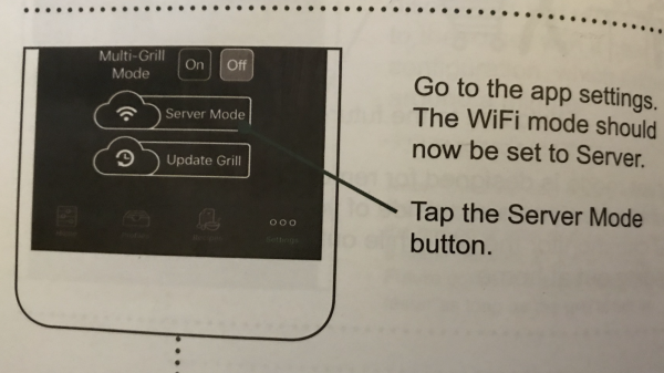

    The new GMG grills not only have local mode but server mode using WiFi on the smartphone app,
    Due to FCC regulations you cannot start a wood pellet grill remotely. Only locally, that is why blue tooth is used for many such apps. This new GMG Daniel Boone DBWFSS model grill has a local mode to start the grill and a server mode to monitor the temps if you go out on an errand when smoking an 8 hour brisket!
    In server mode you cannot start the grill and potentially burn the house down if it is next to a combustible material and of course you ca not see it! Great philosophy, don’t junk your car if a small knob is broken?
    So lockout the starting of the stove but be able to see and control the temperature! Good engineering!

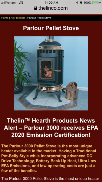

    All the pellet grills are going Direct Drive to keep temps constant! This means starting and stopping fans and auger motors a lot! The new Brushless DC motors are perfect for that! AC motors would kill the semiconductors especially the triacs! These grills can also be plugged into the car cigarette lighter or used on a boat! So they are just as good as the new Thelin Pellet Stoves (2010 and newer) with brushless motors and last a long time! Also having a surge protector on a DC stove is far from a critical much needed device for an AC stove!
    The older Thelin brush type motors did need more servicing!

    Pic 1 - Server Mode - Allows you to see the temps of your grill remotely but not turn the stove on. :)

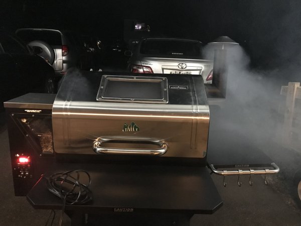

    Pic 2 - Pellet Grill is smoking hot!
    Pic 3 - Thelin Parlour

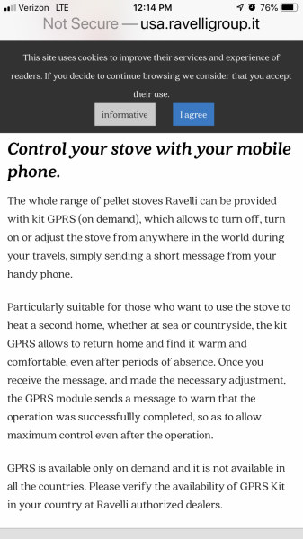

    Currently No manufacturer can produce a pellet stove with WiFi control because if you are far away and cannot see if there is any combustible material next to the stove and start the house and the house burns down then it is a fault with the pellet stove. Therefore if the stove cannot be turned on unlesss you are local it relinquishes the manufactures liability and gives the user the most types of remote control and distant monitoring and temp control.
    There are some china stoves with blue tooth remotes but they only work locally.
    The WiFi thermostats sold separately are at the user’s risk and not tied to the manufacturing.
    Pellet Grills with WiFi from the manufacturer can only be started locally but can be monitored from far away and comply with FCC regulations. :)

    Um really? I guess i am confused,some pellet stoves can be controlled by phone,by internet, which generally go through WIFI in the residence. RIKA was the front runner of this system,many years ago.Bit perhaps I do not fully understand. Anyway,been busy,nice to talk to you,Don.
