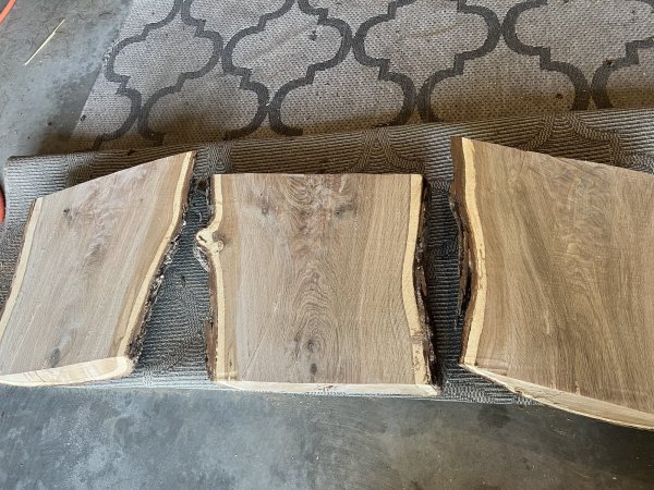

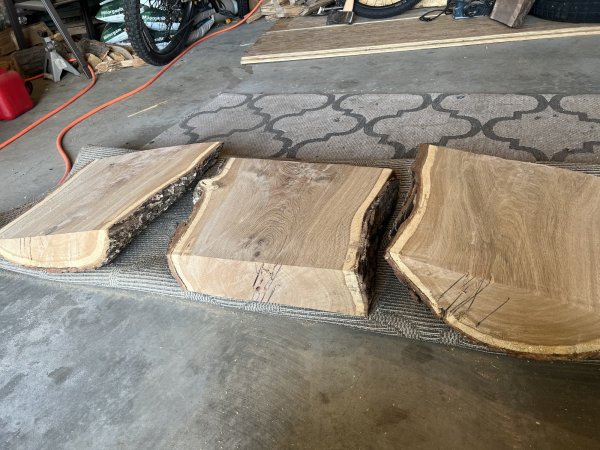

    I’m sure these will crack but hopefully can salvage some larger pieces

    With grain that twisty i end up noodling them into "splits" unless you like twisty splits.
    Pretty grain though.
