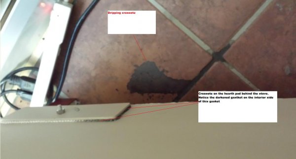

    Something really sounds weird here and I simply do not understand part of it.
    I do understand you are upset about the free shipping or lack of it. Different sales come and go. I recall when we purchased, we got free shipping. Yet several months later a bigger sale came along. It did not bother us as we got what we ordered at the sale price that was offered at the time.
    Forklift driver beat up the stove? It is then their responsibility to replace the stove or fix it; not Woodstock.
    What I don't understand is the creosote. It has been my experience that creosote is caused mostly from burning very poor fuel. And if the stove "shat creosote out the back," one has to wonder why and what fuel was being used.
    As for Woodstock going silent, this too is difficult for me to believe. But you can double check on all these things with a simple telephone call. And when calling, keep the conversation clear and to the point. Keep emotions out of it and it will go well for both parties.
    Good luck.
    Maina, fox9988, wildwest and 2 others like this.
  7. BDF
    BDF
    Jul 22, 2014
    2,160
    7,533
    Virginia
    He posted a photo of his stove leaking liquid creosote onto the floor from the back / left (same side as the door latch) of the stove. There is a plate there with a gasket that covers the opening which the draft adjusting plates slip into; in other words, it is the very beginning of the intake tract on the bottom of the stove.
    What you say about burning good wood is all correct and fine but still, no stove should ever leak anything out of the firebox onto the floor, especially so from the intake (draft) of the stove. I suspect something is wrong with that stove- perhaps a seam did not get welded or sealed or something similar. I have had my own stove generate so much liquid creosote inside that it actually ran down the ash pan door and stuck the ash pan door gasket to the ash pan face; this was after days and days of running very low and slow with the combustor cleaning up the smoke coming off of a smoldering pile of wood. And still creosote did not leak out of the stove anywhere, and the intake tract is clean and has no creosote in it. So that leads me to wonder if something is not quite right with this gentleman's stove.
    And just like you, I believe Woodstock will make it right if they are aware of it and understand the situation.

    The forking :)D) company is at fault. That said, leaking creo is a problem. Obviously the stove shouldn't leak (forking problem) but there also shouldn't be creo to pooling up to begin with. I suspect the wood. Creo doesn't pool vs leak in the rest of our wood stoves. If Woodstock considers the Forking company responsible (as they should) they should just say- the ball's in their field. If they haven't. If your car gets forked up during transport, the manufacturer doesn't deal with it. Its an unfortunate situation. Best of luck.

    Dripping creosote in a stove is wet wood, stalled cat or something gone wrong. That should never happen. Condensation buildup in the top of the chimney is more reasonable. Your firebox temps should not be below 260 degrees while there is moisture still in the wood.

    My wood is two year old white oak which reads single digits on the outside and low to mid teens on the inside, so it's not the wood. Here is a re-post of the leaking creosote: Ideal steel creosote.jpg
    I work for a global professional services firm and we have a rule, "Clients first, prospects second". In other words, attend to client needs before engaging in sales activities. I understand that Woodstock is backed up on production due to a number of issues, however, the dripping creosote problem was presented to them 02/01/2015, questions received and responded to 02/02/2015 and nothing since. That is not "clients first, prospects second", especially when free shipping is being given to new customers. If Woodstock can absorb a $250.00 shipping cost on each new Ideal, they can dang sure take the time to respond to a documented problem for an existing customer. This is not a subjective complaint from a novice wood burner like what we used to see on the other site...."HELP! My dealer said I'd get 14 hour burns and I'm only getting 13 hours!" etc etc etc. Weather depending, one weekend I'm going to disassemble the stove as much as possible, look for the source and take some photos. Don't get me wrong, when this stove is doing its thing I love it to tears. But dripping creosote? Erh, um, uh......:headbang::picard:

    Golf.... I feel really bad for you. Has the problem continued, or was it only one time? If I run low and slow for a long time, I get a lot of the creosote build up in the box and on the window. During the day when it is warm I have been running a couple of splits with some coals to have a small hot fire to burn of the creosote. I have noticed if I load it full then turn it down it really pyrolizes the wood and blackens the box. If I only run a few small pieces I can burn it off without running myself out of the house. From your description, it seems your wood is good. IF it only happened once, then maybe it was one or two pieces of wood that was jiggered up somehow. Do call them and remind them. I am pulling for ya...

    Given that info., agreed, they should have contacted you long before now. Again, I would suggest contacting them, specifically the person you were in contact with back in Feb. and ask what the status is on your warranty issue.
    Also fully agree with your idea of finding the problem yourself. In addition to looking inside the firebox, I would pull the draft cover and look in there with a strong light to find the source of the creosote, or at least the general idea of where it is getting into the draft well. Then pass that information along to Woodstock so that they, and you, can best determine what needs to be done to address this problem.
