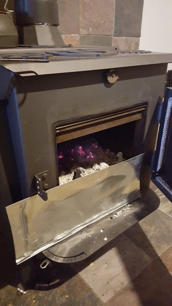

    I've been fighting the smoke spillage issue again. I've tried many things to counteract it but the only solution I have found so far is to last a piece of sheet metal across the bottom portion of the opening. This seems to be the ticket for me. I have a few ideas.
    1. Keep doing what I am doing or create a mechanism to do it better.
    2. Install BDF'S draft inducer
    3. Modify and or try wider andirons to reduce the opening.
    4. Weld material to the door opening to make it smaller.
    The opening is just way too big. I know others are dealing with this too. I imagine those with the perfect layout are fine, but most don't have that.
    chance04 likes this.
