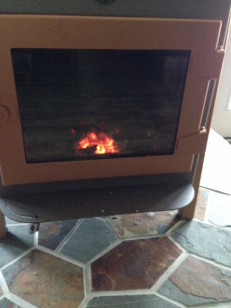

    I'm amazed! I loaded the stove about 80% full for the overnight (around 12:30 am) and this pic is from 12:30 pm.
    My stovetop is 200 and still plenty of hot coals. Going to be above 60 today, so I will probably do a cold start tonight for another overnight burn. We had a low of about 30 last night, and woke up to a 71 degree house. Love it. One tip, I guess it's a pretty obvious one: I have a setting on my hvac that turns the fan on every 30 mins for a 10 minute duration, and it seemed to help distribute the heat into the bedrooms some last night. When it was running, I used the ir gun on the hvac vents, and it was blowing out 68 air. Not bad!

    Fun isn't it! Ive had mine for a year now and I'm still amazed how long of a burn I can get. I bet it was really cranking the heat out last night when you went to bed. What type of wood did you load it with yesterday?
    I also have the furnace fan that can cycle on and off. I messed around with it last year, but then chose not to use it. My ductwork is located in the attic and although it's insulated really well, I still it gets cold enough to not help me with circulating the heat without losing some of the heat in the process.
