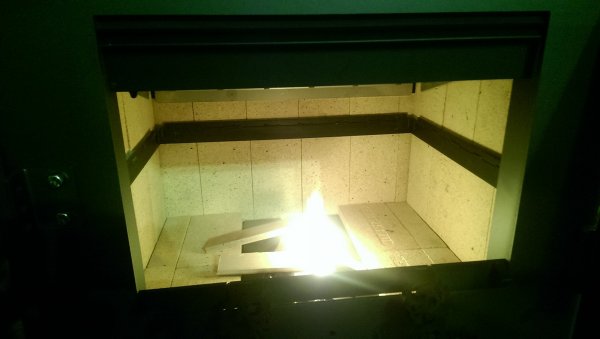

  8. Babaganoosh
    Babaganoosh
    Sep 7, 2015
    1,137
    3,828
    Jersey Shore
    Got some kindling and some small pieces of 2 by 4 going right now.
    I've got double wall pipe so how do I know when to turn the air down? They say when the single wall pipe says 250 but I've got double wall
    Brad38 likes this.
  9. Canadian border VT
    19,826
    132,259
    Babaganoosh Don't worry with that small of a load you probably won't even get to 500 inside.. keep air open and don't engage the cat you will be fine!

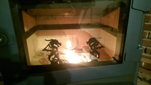

  12. Babaganoosh
    Babaganoosh
    Sep 7, 2015
    1,137
    3,828
    Jersey Shore

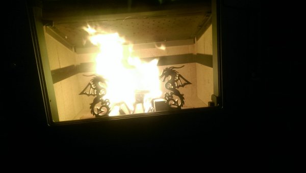

  15. Babaganoosh
    Babaganoosh
    Sep 7, 2015
    1,137
    3,828
    Jersey Shore
    That was a few very small splits too. Going to pick up a probe thermometer today and try to get the cat to light off with a bigger load.
