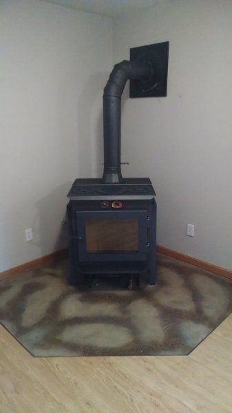

    IMG_20160210_071949281.jpg Lookey what I dragged in last night. Couldn't have been easier back up to door, pull off trailer with pallet jack, set in place, pull pallet off and walk off the back of the pallet onto pieces of pallet stacked 3 high, then tip backward, pull out pallet and set front legs down, tip forward nd pull out pallet pieces. Done.
    Can't do first burn until tonight...if I get home in time. Any tips for first burn?

    Nice. Camo floor? :thumbs::dex:
    Look in the manual....maybe there's info on the burn-in procedure, but usually you start with a small kindling fire to a couple hundred degrees...let it cool, then do a couple more with higher temps each time.

    freeburn, the manual says start several small to medium fire to cure soapstone letting stove cool each fire.. but what is a small fire.
    what I did I had some small pine splits. kindling and three small splits pine size of 2 by 4 ....6 to 8 inches long was fire one
    next was 4 splits same size then 6
    I never engaged cat during curing fires... stove top was about 150 on first 225 second and 300 third IIRC
    then did small load 25 to 30 % full of popular. just trying to dry natural moisture out of soapstone

    Not supposed to be camo, but now that you mention it. It kind of does look like it. Stained concrete tried to make it look kind of like stone...or camo.

    I almost couldn't see it......being camo and all.:D

    I did a few curing fires... first one just kindling with a few bigger pieces of kindling. The second was a few small splits, and the third had a couple of medium sized splits too. The manual isn't very descriptive, and the stove ships with a tag that specifies a curing fire but contradicts the manual, mentioning I think one long burn.
    I think the important thing is don't go from cold to normal operating temps right away the first time you fire it up. And it is going to smell, so hope for a warm day you can have a window open.
