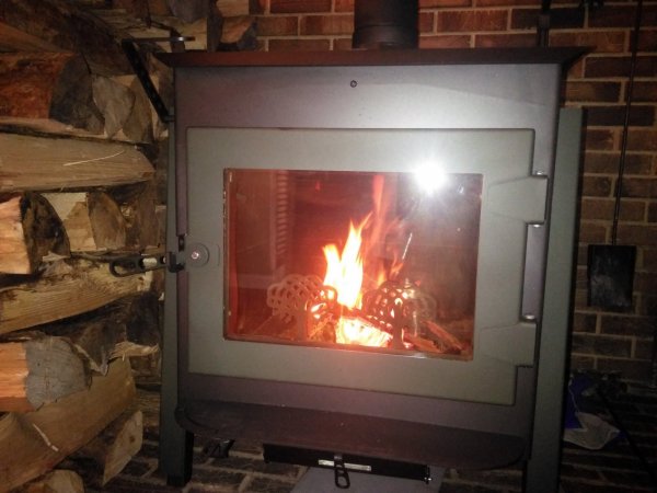

    Well,
    The Mrs. wanted a fire.... It is cold enough to cure the paint that was touched up. I will try to get up to a medium fire by Sunday
    Proof you say?
  3. HarvestMan
    HarvestMan
    Feb 22, 2015
    744
    3,272
    Southeastern Michigan
    Yikes! How close is that wood to the stove?

    Most of the shoulder season burns I do turn into cat only burns. Maybe I don't have enough chimney draft for the secondaries.

    Very close.....
    The IS actually is better than my old Lopi. Most of the heat comes up the channels or from the front. I spent a couple of years keeping a close eye on it. When I installed the IS I was afraid it would get too hot, but the soapstone sides must help. I only had a problem once:
    My sister came over to watch our baby for the evening while we went out for a few hours. We got home at it smelled HOT and there was the faint smell of smoke in the house as well. My sister had put wood into the stove (Lopi), but never closed down the air intake or the bypass. It was really hot! I had to pull a log out and throw it out the window and shut the stove down.....
    That is the only time I have been worried so far :)
