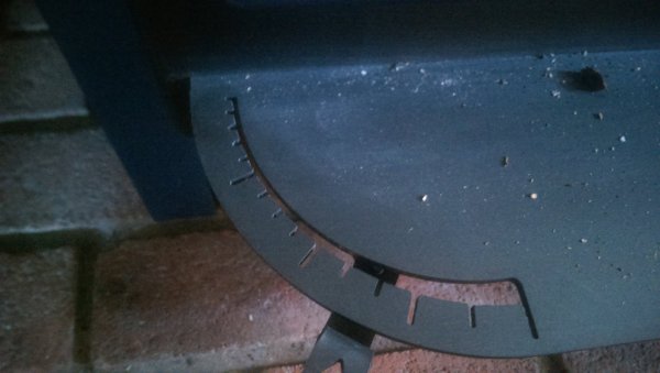

    Alright, here's a good question for everyone.
    What's the lowest notch you have set the stove to during a burn?
    Also what do we call the first notch? Zero? One? Is the air closed down completely at the first notch (not counting the air port behind the door)
    My lowest has been one notch under the first large notch. If we call the first notch zero then it's four, if it's zero, well then the lowest I've been is five.

    With the lever slid all the way to the stop I call zero. Much like the first notch is zero on your speedometer of your car, well, I think, and the bottom of a chart or graph is usually zero. The first big one I call 5. The air is never fully closed, you can see if you look under the stove that when the slider is all the way against the stop the secondary air plate still is partly open. With that in mind, mine has cruised right along just fine on setting of 2 for long burns. It is set that way right now.

    Finally, we are down to the fundamental questions.... what is the first notch called? Now if you ask and E.E., he / she would say it is called zero because all things start at zero (the seven bits in a byte are zero, one, two.... and finally, seven). But of course REAL PEOPLE do not play with electrons so dem dare sparky types must be wrong. :rofl: :lol:
    I call the first notch 1, and the first large notch (the sixth notch) 1/4 draft. So I would say you are running your stove at one notch below 1/4 draft. All of that said, it would really be up to Woodstock to 'name the notches' though. :)
    No, the draft is not shut off when the draft is moved all the way to the stop. The primary draft in closed but there is a pretty sizeable draft to the secondaries (the stainless steel plate with all the holes in it at the top of the stove). Also, there is a hole in the front of the stove, just under the door sealing area, that feeds the firebox air and is not adjustable. Occasionally, with my new chimney, there is sufficient draft in my stove that I can shut the draft all the way down and not cool the combustor- that was not the case with my old chimney. My stove can and will run for over an hour with the draft shut before the firebox and cat. begin to drop off in temp. Of course, cracking the door immediately cools the cat. as well as the firebox and flue temp. because it lets in air that just races past the wood, through the combustor and up the chimney without really giving the fuel any oxygen.
    My stove will run well at the second notch but only while the wood is gassing; once all the wood is outgassed (in other words, no more fuel for the cat.), the stove temps. drop way down and the stove will not produce enough heat when it is cold outside. So I have two choices: set the draft open wider for the whole burn and overheat the house a bit or get up first thing and kick the draft open in a chilly house (outside at 7F, furthest room from the stove at 66F, stove room in the low 70'sF).

    I might add that the uneven amount of small notches between the large notches bothers my sense of order.

    Guilty as charged. But us E.E. types could also say that while everything does start at zero, you could say that since the air is partly open by their design when the lever is all the way to the end, that zero is there - but below the first notch and not reachable.
    Yeah at first I thought it strange. Much nicer to have like every fifth notch a larger one. I wondered why, but in my examining of the air controls that I am working on I think I realized maybe why they did it that way. On the more open end, the air plate doesn't move that much, but the notches are spaced larger. On the mostly closed end of the scale, the air control moves at a greater rate but with very small notches. The end result is that they balance each other out, the movement of the air plate is about as much between the first two notches as the last too. That is of little importance to us end users though, just something I wondered myself.

    Now that right there is funny! :) M.E. myself although as an automation engineer, specializing in motion control, I have written a lot of code and designed more than a few circuits. Glad to see you took a good- natured ribbing in the manner in which it was offered..... thanks!.
    Agreed about the un-even spacing on the draft notches. The draft is very non- linear anyway, and it is further complicated by the fact that the draft openings cut into the draft plates are not slots but rather complex shapes.... so moving the draft 1/4", say, near the closed area is very different than moving it the same 1/4" near the fully open area. And finally, there really is no 'fine tuning' past, say, 1/2 open draft anyway while there is certainly a big difference in one small notch of draft change below 1/4 open.

    Hey B, I'm confused. Does your pic represent your lowest burn?

    Nope. Just threw the pic out for the "what do we call one on the air control question"
