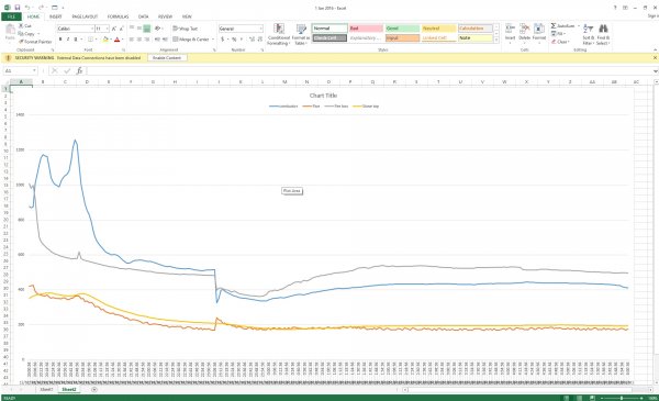

    s file this one under "Exactly what NOT to do with a wood stove."
    Last night I was feeling pretty lazy (way overfull of food) so I just stuffed a bunch of wood into my I.S., closed the bypass, and left the draft set to the third notch, which is a slow burn setting for overnight.... once the fuel has been charred and the stove is hot. But the stove was not hot and I really knew better but did it anyway. This morning, the house was cool and the firebox and glass were coated with all that black tar (creosote) from a smoldering, dirty burn. I have not looked but I am sure the chimney is full of it also :-( This is the data from that burn:
    You can see exactly where I loaded the stove- the temps. of the flue and stove top never really broke 200F. The entirely load of wood just pyrolized (glowed but showed no flame, like a cigarette), produced very little heat and made a pretty large mess. This is exactly what the EPA is trying to prevent but as you can see, improper operation will still carry the day and defeat the best intentions and designs of wood stove manufacturers. Just like driving a car into a tree I suppose.....

  11. papadave
    Cause and effect.
    Do you dare burn a hot fire to clean up the firebox and flue, or will you check the flue first?

  12. JA600L
    JA600L
    Apr 3, 2014
    762
    1,702
    Lancaster, Pa
    This may be where BK's thermostat could have helped. Where maybe an auto function would open the air back up to revive the dead horse.

  13. HarvestMan
    HarvestMan
    Feb 22, 2015
    744
    3,272
    Southeastern Michigan
    Thanks for sharing this. I appreciate your honesty and it helps me realize I need to be prudent about both closing the bypass immediately (making sure stove is hot enough) and getting sufficient char time before closing down the stove. This is probably what Backwoods Savage was cautioning me about in the other thread where we talked about reload technique for cat stoves. I've listened to both what you and Dennis had to say about it and will likely be pretty conservative going forward as to avoid what your graph shows.

  15. BDF
    BDF
    Jul 22, 2014
    2,160
    7,533
    Virginia
    With the old, masonry chimney, I would have taken a look and probably done a cleaning (I could clean it from the basement). With the new SS Class A chimney, I just sort of forged ahead and started burning again, banking on the fact that the chimeny is not over- loaded with creosote. That plus the fact that I just do not ever let the flue temps. rise above 700F; I believe it will take substantially higher temps. to set creosote on fire. I may well be deluding myself but I think that is the case..... so I am hoping that further correct and clean running will be fine with the chimney as it is. I will check it in a month or so just to be sure though.
    I did burn the stove a bit on the hard side, with flue temps. staying around 650F, to clean up the firebox and glass, which worked very well.

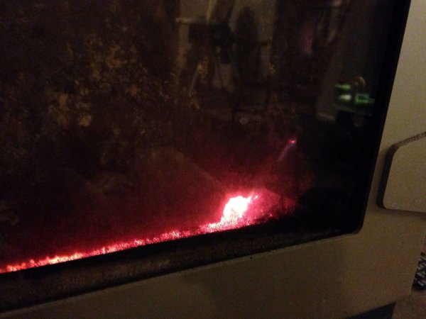

  19. Beet Stix
    Beet Stix
    Mar 4, 2014
    124
    415
    NW Ohio
    I have never noticed such a distinct burn hole on the front right. I assume this is where air is entering the stove based upon how coals glow on that side at the end of a burn.
  20. Babaganoosh
    Babaganoosh
    Sep 7, 2015
    1,137
    3,828
    Jersey Shore
    Does it on mine too. Also the left side is where the glass tends to get dirty.
    Canadian border VT and NVhunter like this.
