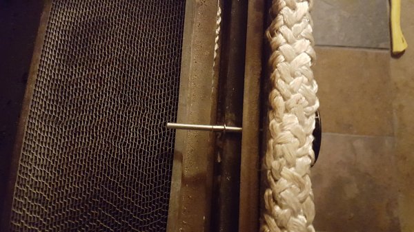

    I ordered the condar 3-12-1 catalytic temperature probe. According to my dimensions it should work. I also got confirmation from another owner who has done it already.

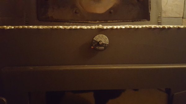

    There you have it folks. The Condar catalytic probe. It looks a little funny with the lid down. You can tell that Woodstock did not put much effort into this part of the design. It should work though.

    What if you turned out upside down?

    Well you could. ...

    Looks like the stainless steel port liner they ship with the probe is not in the probe port, but inside the stove in the middle picture.

    Wouldn't that make it easier to read from across the room

    You don't need it for this stove. So I put a pinch on it and slid it over the probe. It helps steady it.

    Makes sense now. Looks like it is snug against that black metal piece in the picture; that should help it from moving. The Condar probe I had in my old stove was fairly snug, but it would rotate over time: I tried to keep the 500 degree mark at 12 o'clock so that I could easily read it. Now that I have a Fireview the cat probe isn't an option; probably just as well, one less thing for me to think about.
