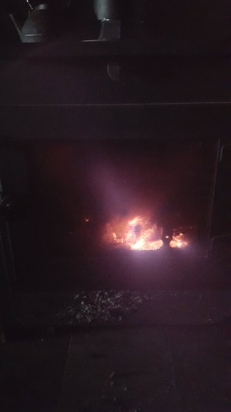

  16. Babaganoosh
    Babaganoosh
    Sep 7, 2015
    1,137
    3,828
    Jersey Shore
    Just some nice secondary action tonight before it went into cat only mode.
