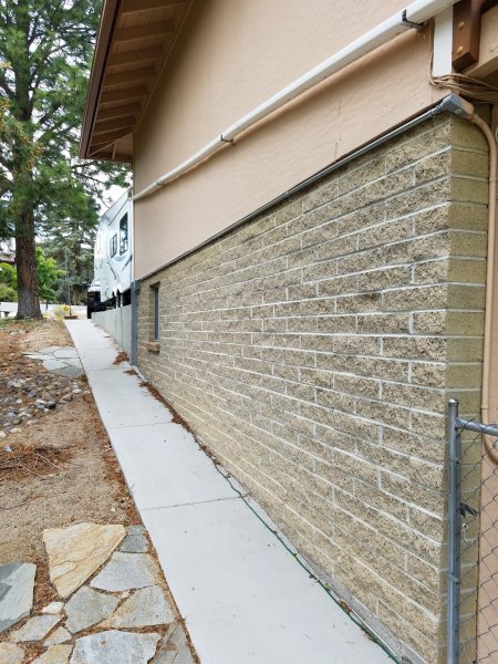

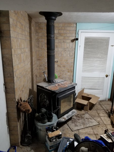

    I didn't know what it meant until I bought a house with one...
    A daylight basement is part of the basement is open and exposed to the grade of the back or front of the house. Typically one haft the house's basement is below grade.
    Here are some pictures of my place...
    The stove is on the right side of the house.

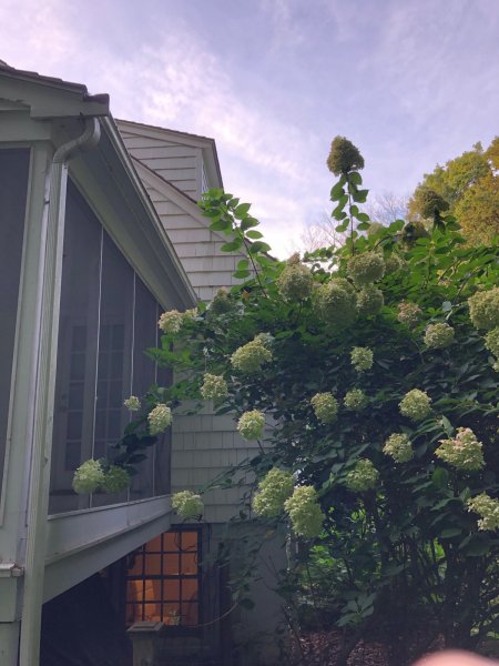

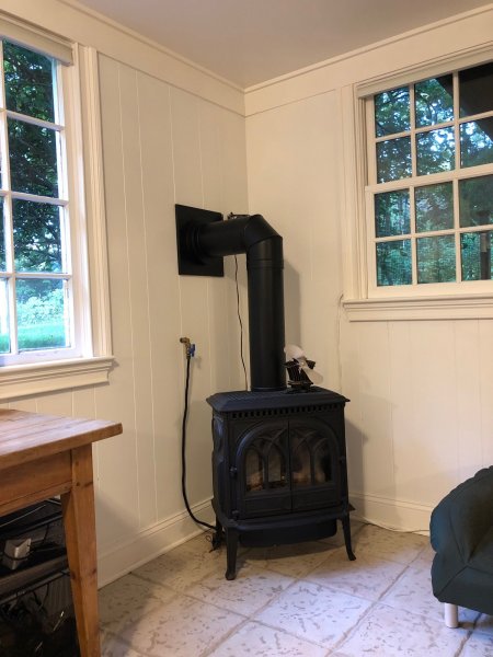

    Apologies for not posting any pictures of the setup. The current propane stove will come out - I stupidly vented the gas stove on the wrong wall not thinking I would ever put a wood stove in. The wood stove will need to be vented on the right side wall. Concrete floor with tile over top, so no need for a hearth. I will need rear protection where the wallboard board is.
    Venting of wood stove => straight up 3 feet then two 45 degree bends then outside. I will then need a tee (clean out) on outside of house. Please let me know if I am missing something here. The venting then goes up 14 feet to the top of first roof line. I suspect I will need to go up another 4-5 feet above first roof line but need to take some additional measurements. Most likely will have it professionally installed.
    Simply fed up with my propane price going up every 6 months. It was economical a number of years ago but the price just seems to steadily increase.
    The local tree guys look for wood burners like me to "drop off" wood, in SW Connecticut they apparently have to pay to dispose of it. Arborist drops it off in 15 foot sections, I then buck, split and stack.
    I am 99.9% sold on the IS over the Ashford. The smoke smell is a bit of a deal breaker even if it is uncommon. Thanks for the heads up on that.

    It could work, but the stainless steel liner would be a bit of an eye sore in the back of the house. My planned location is on the side of the house and nicely hidden.

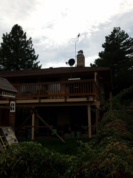

    I heat our whole house from a walk out basement installation with an outdoor chimney. It is very convenient for cleaning the chimney and bringing in wood. The woodstove sets close to under the forced air return duct to the furnace. I have opened that up and keep the furnace fan on to move the heat throughout the house. We have a 2800 sq.ft. colonial.
