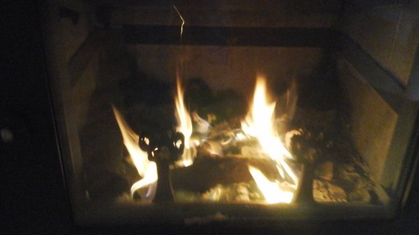

    Put some wood in it! :smoke:At this rate, that 14 cords will last for many, many years.
    I'm sure your good to go.... and we need to see the secondary lazy flame pics. ;)

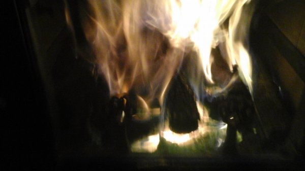

    OK Ok.. :D it's was kindling it had been lit 2 minutes. here's a half load.. will throw cat when up to temperature .. All ugliest maple and apple. experimenting with east west and north south on top... 20150930_182201.jpg

  11. papadave
    Ok, that's gooder.

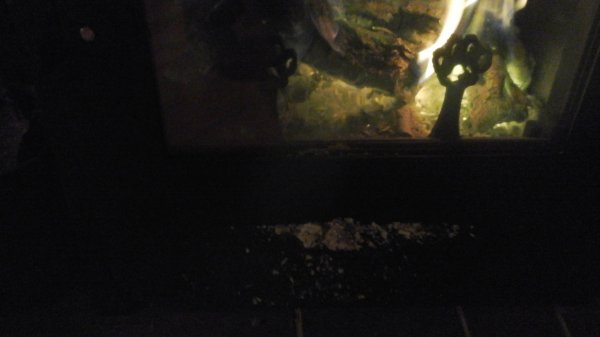

    20150930_200925.jpg OK how do you tell if you stall a cat? OK flames just came back.. I waited til thermostat on single wall pipe, 1 foot up reads three hundred. the wood is dry but not all split I mean little rounds diameter less than 2 inches. just checked one on meter meter 13 percent I will try to do a video..
    no video the extension is wrong so a pic...

    I'm not sure on the temp for a single wall stack. I use 350 for a stove top temp to the right of the stack on top the stove. Looks like you have a hot fire going.
    Looks like your close. you will figure it out, if you have smoke coming out the chimney, just wait 5 or ten minutes and see if it clears up. Cut the air to 25% or even lower. Cat, should easily engage at low air settings after a few minutes if your hot enough and have enough fuel that's gassing off. Little more wood might be needed if your light on fuel.

    Cutting the air down actually can help engage the cat..... Not sure where you have it set.
    If the air is set higher, you end up burning the secondaries which consumes a lot of the fuel (gas) for the cat to burn.

    oh OK it's half and I got draft.. when it went dark for while got nervous.. I will put it down to 1/3 and see what happens. thanks Fanatical1

    Keep taking it down, until the you have a black firebox and see what happens, might be closer to 10% air or less. I often have it set to about 5% plus or minus.
    Interesting to watch when it looks like you put the fire out and then all the gas hits the cat and your stove starts getting really hot with a black firebox. :)
    If you put your temp magnet on the front of the stove just to the right or left of the little cat probe hole, you can easily see when the cat engages as the temp will climb quickly and dramatically in that area as the cat engages. I often leave my magnet there just to see what's happening with the cat as I usually run the stove at low air just using the cat during the winter. I think it burns most efficiently that way and still produces a ton of heat.
    By cutting the air and engaging the cat (if you have enough gassing fuel) this stove will burn hotter at low air settings. When the cats burning with a good fuel supply at really low air settings I often have a completely, or almost completely dark firebox and a stove that's running really hot with almost no fire.
