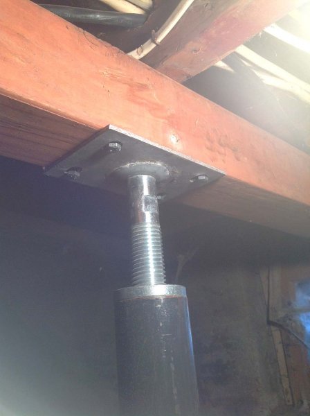

    By the way, due to the weight of the Ideal Steel and the brick hearth, as a precaution we placed a floor jack that supports three floor joists directly beneath the stove area.

    Like a hydraulic bottle floor jack? Me personally, I would use a screw type column jack, or even jack stands, seals fail and bottle jacks let go...

    Sure, we used a "screw type column jack".

    Nice lookin stove kermit and good idea about bracing the floor. Alot of folks don't think about the load some of these HEAVY stoves can put on floor joists.
