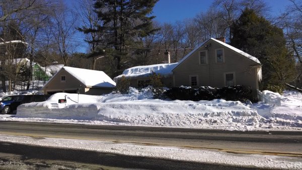

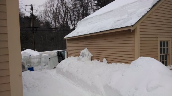

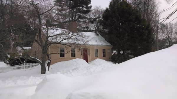

    Got some work done today... Dug out the patio set and moved it so I could snowblow the patio making room to get more snow offh te roof. Widened all the pathways...dug a new path to the front so I could clear that roof.
    Tomorrow I have to do a lot more roof clearing and put more rock salt stockings up on the worst dams. Water in attic but nothing coming through the ceiling thankfully.
    My shoulder is on fire!

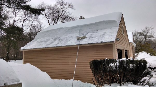

    Here are some more for you. Spent 3 more hours out there today and got more done. Took snow off the unheated garage just because its somewhat under framed and I'm concerned about the load with another foot. Spent a lot of time with the blower moving it away from the house in stages to make room for more.
    The front of the house was real difficult. Melt cycles from sun had turned the top 3 inches into an icy crust that was hard to break through.
    Also piles from what I raked yesterday froze solid overnight in -10 temps and I had to cop them up with a shovel before the snowblower would budge.

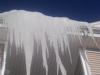

    At work we have well insulated vented attics. I used a laser thermometer on the siding on one of our buildings in full sun yesterday afternoon. It registered 75 degrees. We have most ice dam issues on south facing roofs. Between roof melt-off and the siding warming the soffits and gutters, therein lies our problem. We pieced down this 12 foot icicle yesterday that was about 12" in diameter. You can see in the pic that the deck spaces has vented soffit above it. So all that warming siding is letting heat up into the attic.
    The icicles around here are incredible. There are plenty that are two stories high from gutter to ground. It seems like every few houses has the pantyhose/icemelt thing at the lower rooflines.
    We used a DeWalt sawzall with a short demo blade on a few ice dams, not this one. A few heavy hammer strokes to fracture the ice, and the blade just got in the crevices and shattered the ice. This saw saved a ton of labor. We are going to try a hammer drill with tile drill bit next time. The sawzall worked surprisingly well.
