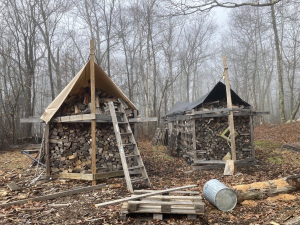

    Dunmeyer you’ve been Given some great advice so far. What you’re asking for is a tough cookie. jrider is the king of large piles and he’s correct in my limited experience. Most (pile people) are storing wood for a shorter time in bulk in mostly drier times of the year. Storing for multiple years things change. IMO top cover becomes mandatory.
    This is what I’ve come up with so far. An experiment to see if I can make it work. There’s been failures along the way, there’ll be more in the future I’m sure. Some years may be drier and ok. A wet year may leave you with a pile of black mold and mushrooms. As some have mentioned getting the middle to dry and stay dry is the key.

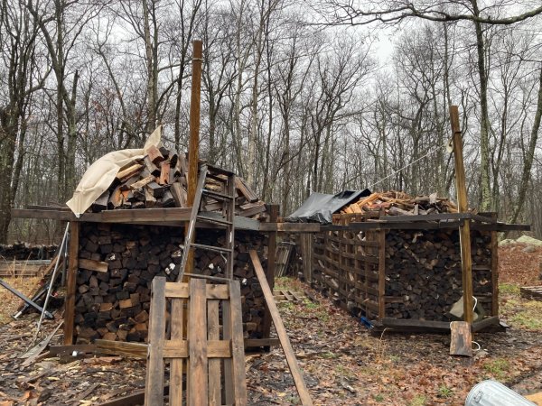

    And here’s the latest failure. 50-60 mph winds produced a little setback :)
    I’ll go on record saying I’m not a fan of tarps for covering wood. They’re not waterproof for very long and then drip in a concentrated area on the wood. A bad tarp laid flat can be worse than no tarp.
    In a floating roof design it allows for drying and they shed water even after they’ve been beat up a bit.
    keeping them in place is still a problem.

    jo191145 very interesting setup sir.
    I'm sure I will have much learning to do switching from indoor storage to outdoor.

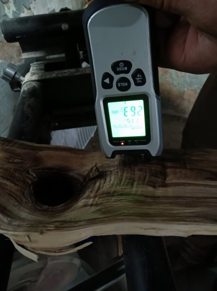

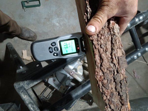

    IMG_20231225_100909.jpg brought in some known wet black walnut at 26 to 30% and some known wet pine at 20is to track how they do curing in basement IMG_20231225_100938.jpg

    Just checking, you test a fresh split? You have to resplit and test on a fresh surface.

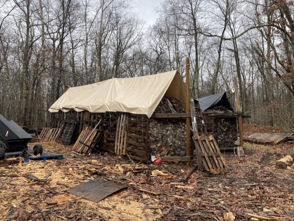

    Slid my tarps back on today. Ready for the next bout of rain.
    I’m formulating ideas where I could “easily” drop them all the way down for the occasional big wind storms. If it ain’t easy I ain’t doin it :)
