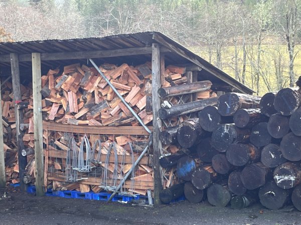

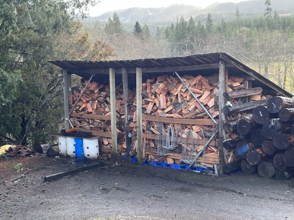

    These are old pictures but the set-up still works well. No stacking, piles only. 12’ deep, 30’ long, as high as I can throw it so about 11’-ish at the peak. Plastic pallets keep everything off the ground, let some air flow from the bottom up and will last forever if I take care of them. No idea how many cords, it’s a 3 year rotation(wish I made 3 holes), with the old Fisher. Wood stays outside either in the shed or on the porch, then arm load at a time inside to burn. MC between 12 to 15% in wettest part of winter. Used to have a huge drying rack inside downstairs but it didn’t make enough difference so I dropped to a small vertical wood box inside for when I sometimes get lazy at night and don’t want to go get an arm load.
    Before the shed we used real truck tarps, PVC roofing and pond liner membrane to cover the piles. They all lasted really well and we get a lot of wind also.

    If you aren't going to stack it, that's how you do it :yes:

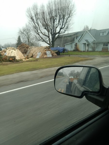

    *not my stacks*
    But this dude's in the pile camp.

    Nice shed, what are the cables hanging on the front used for?

    The side of the house has a hot spot. I like the not 4 sale signs

    Stretching fur

    Holy cow your right looks like a previous chimney fire. Gotta drive by again, 1 more load to finish this job, gonna try to get an eye on his chimney, looks far from code/safe

    He is obviously burnin wet wood too...look at that slobbery mess running down the side of his house...but some of that may be from an improper chimney too.
    As much work as they put into that pile, it would not have been much more work to just stack it and top cover...done.
    Not much to emulate there...

    Pretty sure this guy is splitting now for this winter. Not good. All his piles look fresh. Might not be able to see in picture but he has a couple attempts at hozernhousen or whatever that word is

    He has enough wood there that I wonder if he is trying to get ahead now (since he is obviously NOT selling it! :rofl: :lol:)
    Either that or their stove and house are really inefficient!
