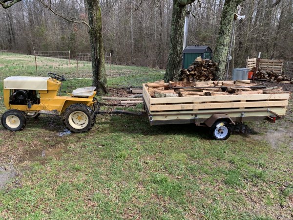

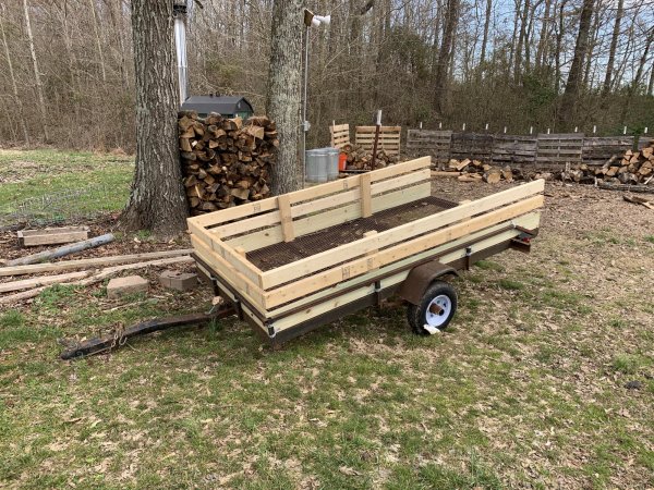

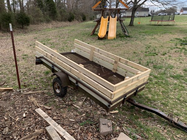

    7F1BE890-24A8-4336-B3D8-3F2F38BE48BA.jpeg 31A7AF4A-2313-4454-9B95-660F37479A1E.jpeg 12734824-AED1-43CC-9F1F-948BA3DCC900.jpeg This is one I got for little to nothing. It’s 4x8 and can easily haul about half a rick. As a matter of fact that’s what’s on it in the picture. It can very well hold more. I think it’s a golf cart trailer or something it tilts, so who knows it works for me right now.

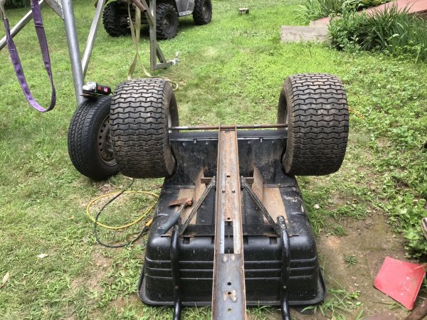

    On my little trailer I widened the axle and slapped on some big lawn tractor tires. The narrow wheelbarrow tires I found useless. Mostly because the high center of gravity fully loaded and narrow width would flip over in ruts. Flipped it on its first load coming out of the woods :)
    As Dennis said I’ve noticed it’ll flatten out the deeper aggressive tracks from the atv in wet lawn. A plus.
