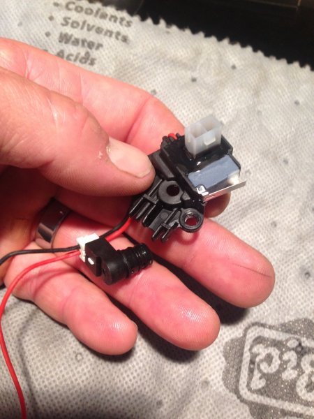

  13. Redfin
    Redfin
    Mar 1, 2015
    922
    4,269
    central Pa
    No. This is the carb solenoid and harness that must remain connected to the mtron coil for the saw to fire. IMG_2707.JPG
  14. Redfin
    Redfin
    Mar 1, 2015
    922
    4,269
    central Pa
    This is the same connected to the wj134a mtron carb. You can see how the stock arm contacts the switch when set to start. IMG_2708.JPG

    So could it be possible that Raphlie's saw is not contacting the switch or he has a bad switch?

    Probably a wire harness problem.
    I believe they would give trouble time to time.
    Check connections and continuity or just replace the harness all together.
    I have one if you want to try it.
