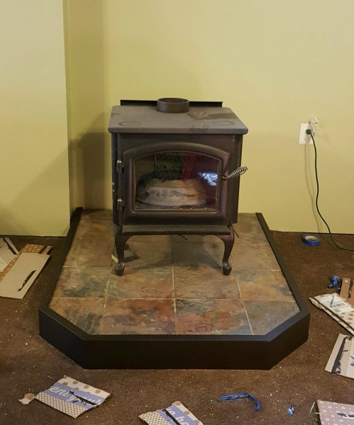

    Yeah. Keep screwing. Assuming the base is level, I don't think you'd have any issues. Five sheets of Durock with whatever tile you use should get you to R= 2. Just a thought.
    wildwest and papadave like this.
  2. papadave
    Next Gen is .39, so 5 layers and tile is just a teeny bit less than 2. My hearth doesn't get extremely warm even when running pretty hard.
    1.97 is pretty darn close.
    1/4" tile only adds .02.

    I have a question on cement boards, I see durarock, hardiebaard, and wonderboard. The hardieboard appears to be denser; I saw some in Lowe's. It is only a few dollars more than the durarock. Wondering if anyone had anything to say about which is the best to use.
  4. papadave
    What you want is the highest r-value stuff you can get, so unless you plan to get some Micore, Durock is your best bet.
    I used Wonderboard, but it doesn't have as high an r-value as Durock.
    HDRock likes this.

    I am going to use micore because it is all I can find. The durerock/wonderboard/hardieboard is used for the surface to support the weight of the stove and for the surface material which will probably be the cheapest tile I can find at Lowe's.

    Those cheap slate tiles are about $1.50 at Home Depot here. That's what we used. There are big variations in color and thickness though, so you'd have to pick through them.

    Got mine for less than $1 apiece. 12"x12".
    I really wanted to do slate though.

    Of those three durock has the highest r value. I wold recommend using that since it never hurts to have more r value. As far as support I've worked with both durock and Hardie backer and I would say they are about the same.

    The surface material is not as important to me as getting the needed R value and stacking six boards of durarock does not appeal to me.

    With Micore, 2 layers of Durock, tile/thinset, you're close to 2".
    With 6 layers of Durock, plus tile/thinset...a little over 3.25".

    I can attest that it will be stable, if that's your concern. "Glueing" the layers together with mortar will give you pretty much a monolithic block of masonry.
  13. papadave
    I can also attest that it will be stable.
    I couldn't move mine unless I used a sledgehammer. Mine is 5 layers and each layer is screwed to the previous one. No mortar/thinset, except under the tiles.
