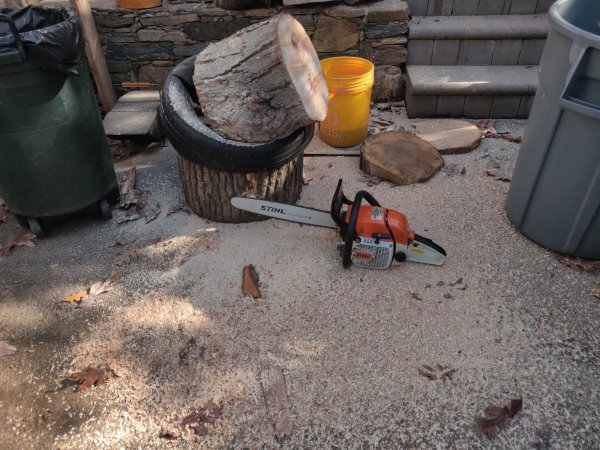

    My wife called it "wood dust" and I almost fell out of my chair.....
    Two slices with the 028 and a freshly sharpened chain on a piece of white oak from the storm tree I cleaned up finally. I was using a 5/32" file but then realized I should have been using the 3/16" on the RS chain.
    This thing roars.

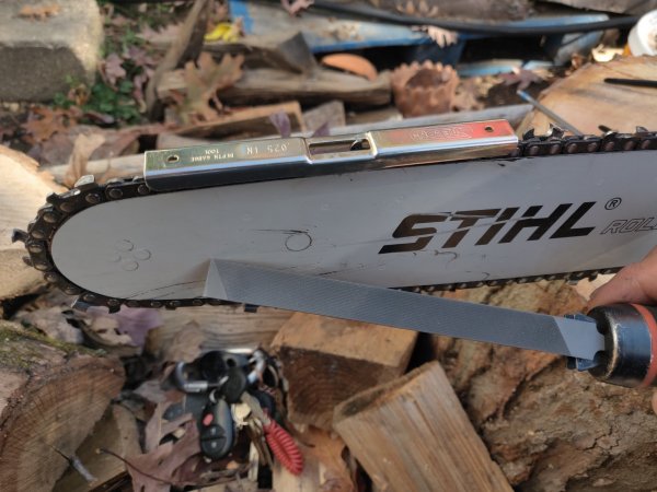

    Also picked up an Oregon .025" raker guide and file. I lost my file when I sold the Stihl 2-in-1 to a fellow FHC member recently. I checked the manual and it says to use .65mm for the raker gap = .025". The guide works well on both the Stihl 028 and the Makita XCU03 36v LP 3/8" .043 gauge chain as they both use .025" for the raker gap.

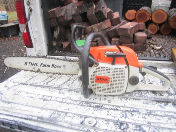

    Love an 028! Cant beat a freshly sharpened chain!:saw: IMG_2112.JPG
