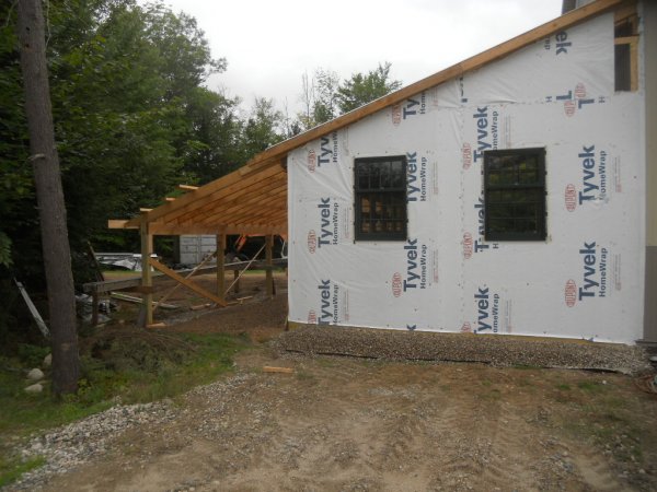

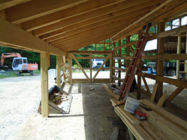

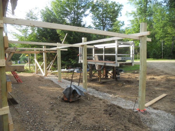

    The roof metal will be ready thurs.

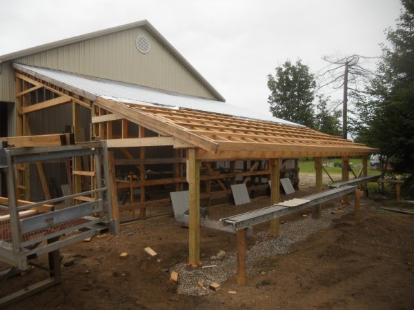

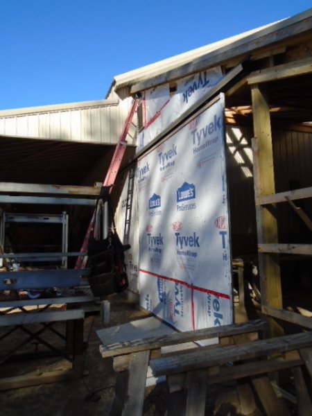

    I'm hoping that these deep gravel footings will drain and not heave in the winter. I've wanted to try it out as I've been assured that it's fine by folks I trust. I just don't trust putting wood in the ground and didn't want to dig in the 4' concrete posts because some where in there my house elec. go's through. It's on the house side of the meter and the utility co. will not locate it for me.

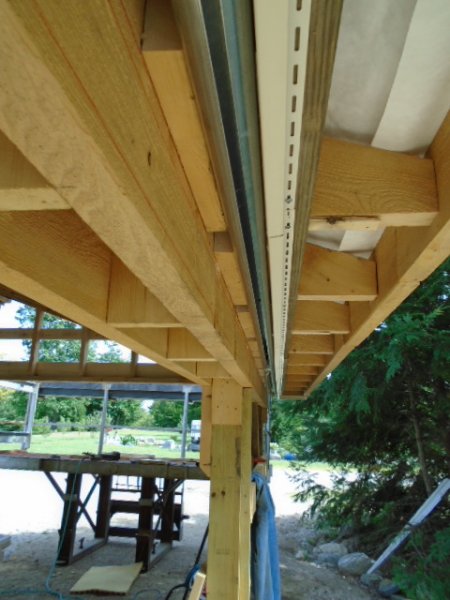

    Still "peckin" away at it.

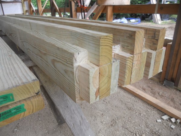

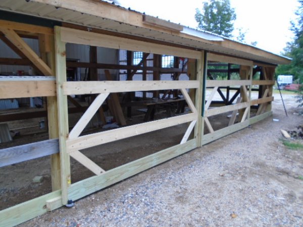

    The little 10' wide bonus room will be for the little stuff that does not need a lot of height, like the Mule, atv's, log splitter, grass cutting tractor and tractor attachments. In order to maximize the floor space I built a pair of doors for each end and a pair of rolling doors for the middle "bay's". each bay is about 10'x9'. The tedious stuff like doors is satisfying but slow progress.
    and a single 11x11 rolling door on the main section.

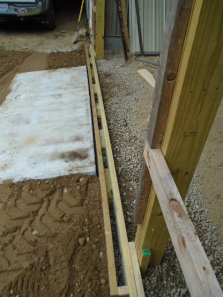

    I hope to keep the mice out of this area, this is the lower door edge "receiver" that I came up with on another building a while ago. Hoping it works ok here in snow country.

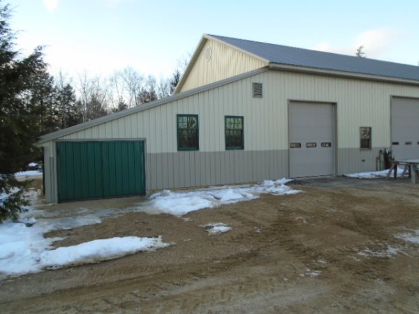

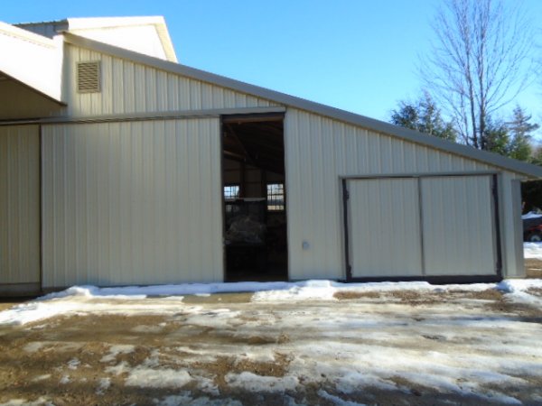

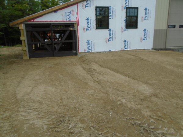

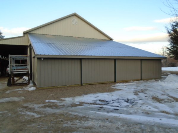

    Well the outside is done, most of the wiring & lights. I'm happy to report that my gravel footers seem to be performing well as the ground has been frozen for several weeks.
    It did heave the ground up at the green doors enough to jamb things up. I knew it would and did not leave enough space when I graded it. Pulled it away on a warm day when the top was loose.
    There's 2 rolling doors @ the middle that roll to the corners for access without moving everything else.
    Another rolling door on the bigger (left) side.
    This is the 2nd time I used this wood "groove" for a rolling door to keep the wind & weather from blowing under the door. It's also on about 3' of gravel for drainage and also is working out well both with the snow & wind and not seeming to heave or move around with the frost.
