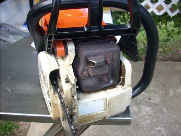

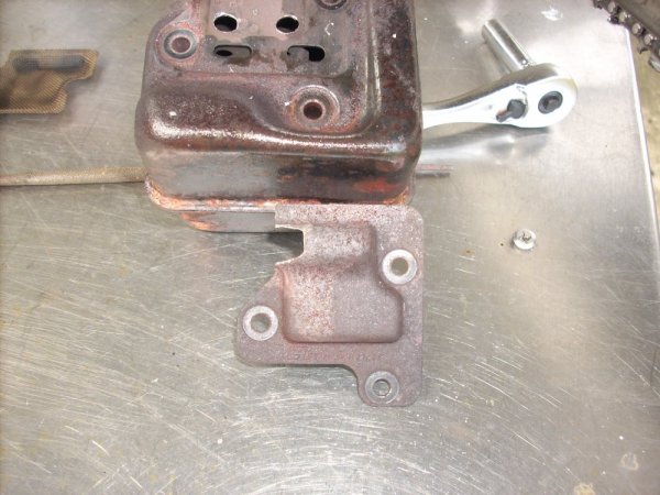

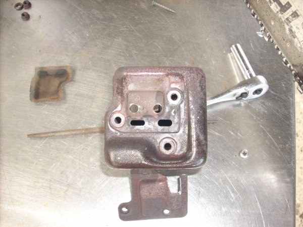

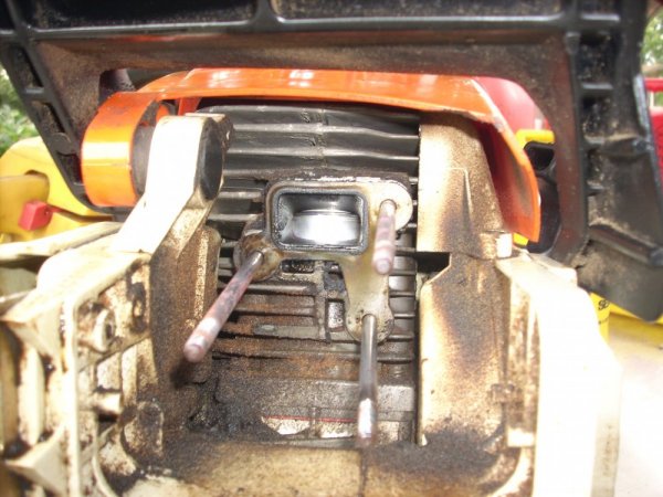

    Scotty, I took your advise and did a "minor" muffler mod on the 290 today. I left the screen in, but I opened up the front more with the grinder and drilled 2 @ 5/16 holes on the straight through to help it breathe easier. The piston looked like "brand new" so I don't think the saw was abused in any way, and the cylinder didn't have a mark on it, "from what I could see"…
    What little bit I did o_O, was a big improvement in the throttle response, :cool:I have not cut with it yet but i'm sure it's gonna be fun:D

    66,319
    Dave make sure you retune the saw........its gonna need richened up to compensate for the easier breathing.....

    @WeldrDave That mod looks great Dave, nice job peeling back the deflector! Those two holes in the dimple are straight-through vents that will bypass the internal baffle. How loud is it now? :whistle::saw:

    It got a little louder but not "screaming" just a bit more "bark"!
    I did tweek it and rich'nd it up, seems to be ok:whistle:
