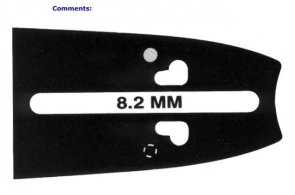

    Small mount - K095/A095/Z095/T095.
    A list of saws this bar will fit...
    ALPINA/CASTOR A-40, C-40, CP-41, CP-45, CP-540, CP-600, P-370, P-410, P-460, P-510, PRO-41, PRO-45, PRO-540, PRO-600
    CUB CADET CS5018, CS5220, CS5720
    DOLMAR 109, 110, 110 EX, 111, 112, 113, 114, 115, 116si, 117, 118, 119, 120, 120si, 120 SUPER, PS-6800
    HOMELITE 30, 130, 150, 150 AO, 250, 252, 290, 300, 340, CS 40, CS 50, EZ 250, MINI SL, SUPER EZ A0, XL-76, XL-100 SERIES
    HUSQVARNA 33, 36, 38, 40, 41, 42, 44, 45, 49, 50, 51, 55, 55 Rancher, 57, 133, 136, 140, 140S, 141, 154, 234, 238, 240, 242, 246, 254, 257, 261, 262, 335, 336, 339XP, 340, 345, 346, 350, 351, 353, 357XP, 359, 362, 444, 455 Rancher, 1400, 1600
    JOHN DEERE CS46, CS52, CS56, CS62
    JONSERED 45, 49, 50, 51, 52, 370, 410, 420, 425, 435, 450, 451, 455, 490, 510, 520SP, 521, 525, 535, 590, 941, 2050, 2051, 2054, 2055, 2063, 2141, 2145, 2149, 2149 TURBO, 2150, 2152, 2159
    MAKITA DCS 430, DCS 431, DCS 520i, DCS 5200i, DCS 6000i
    MARUYAMA POLESAWS: MC-PL11, MC-PS11
    McCULLOCH 1849 AV, 2046 AV, 2049 AV, 4600, 4700, 4900, 5000, 5500, MS 1434, MS 1436, MS 1636, MS 1839, MS 1846, MS 1849, MS 1850, MS 2046, MS 2049, MS 2050, PM 1845 AV, Pro Mac: 40, 46; Silver Eagle: 2818, 3020; Timber Bear, Timber Bear 20
    MTD 152, 162
    OLEO-MAC 941, 945, 950, 951
    PARTNER 410, 510, 540, P-360, P-400, P-450, P-500, P-5000 P 5500
    PIONEER 1074, P-21, P-26, P-28
    POULAN/POULAN PRO 325
    REDMAX G390, G450AVS, G455AVS, G3800 G5000
    RYOBI RFS4518, RFS5418
    SEARS 35084, 35201
    SOLO 614, 630, 631, 632, 638, 639, 641, 644, 645, 647, 650, 651, 651SP, 654
    TALON AC310220S, AC3102-55C, AC310218, AC310318, AC3103-42C
    TANAKA ECV5601

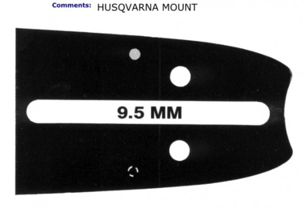

    Large mount - D009
    DOLMAR - PS-6400, PS-7300, PS-7900, PS-9000, PS-9010FL
    HUSQVARNA - 61, L SERIES: 65, 66, 70, 77; 160, 162, 181, 185, 260, 266, 268, 272, 281, 285, 288, 288XP Lite, 298, 365, 371, 372XPW, 380, 385, 385XP, 385XPG, 385XPW, 394, 395, 395XP, 395XPW, 480, 570, 1100, 2100, 2101, 3120, 3120XP, Jungle 3120
    JONSERED - 625, 630 SUPER, 630 WEST COAST, 670, 670 WEST COAST, 2063, 2065, 2071, 2077, 2083, 2094, 2095, 2163, 2165, 2171, CS-2186, RIPPING MILL
    MAKITA - DCS6401, DCS 6800i, DCS 7301, DCS 7901, DCS 9000, DCS 9010FL
    PARTNER - 550,650, 1655, 2055, 7000, P-55, P-65, P-70, P-85, P-100, R-11, R-12, R-14, R-16, R-17, R-18, R-19, R-20, R-21, R-22, R-23, R-30, R-35, R-40, R-416, R-420, R-421, R-435, R-440, S-50, S-55, S-65
    POULAN/POULAN PRO - 415, 425, 445, 475, 505
    SHINDAIWA - (SDK) 550, 575, 577, 680, 695, 757
    SOLO - 603, 662, 665, 667, 667SP, 670, 675, 680, 681, 690, 694

    8.2 mm/ 9.5 is the distance of the width of the long slot for the bar/chain adjustment ?
    or the hole size of the 2 bar mounting holes.
    So my Husqy 61 bar won't fit my 359 ?
    or visa / versa
    Are the bar mount nuts different threads too ?
    Oiler holes different distances too ?
    I "assumed" I could use the bar & bar nuts of the 60 cc Husqy 61 on the 60 cc Husqy 359.
    Not true ?

    I believe that your 61 is large mount, and the 359 is definitely small mount. The bar nuts are the same, I think.
