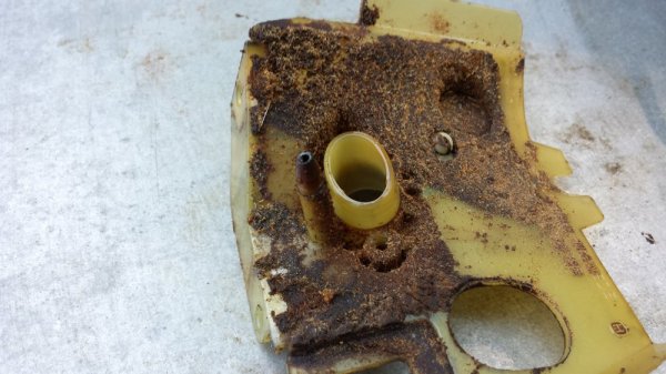

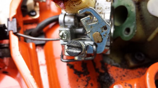

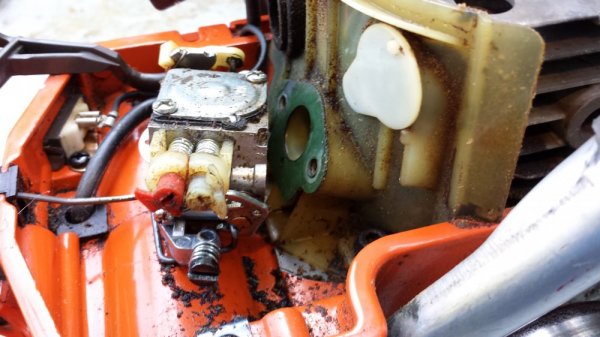

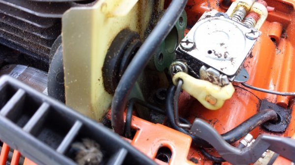

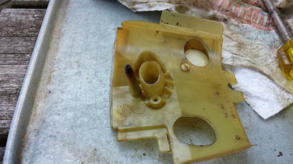

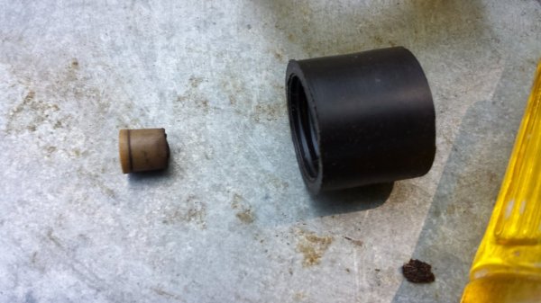

    took it apart didn't really see anything wrong, impulse grommet and intake are pliable and no cracks, intake boot actually looks like new .
    The impulse grommet didn't fit real tight on the plastic tube (slid on and off real easy ) didn't seem like it would leek but IDK how tight it should be.
    Put it back together ,started 3rd pull but wouldn't idle ,adjusted it to keep it running then got out the tach, got it running good.
    WOT it's running at 11200 to 11500, idle is about 3200 lower than that it won't stay running. As far as I know it should be 2500 idle 12500 top power
    IDK maybe I just got it to far out of adjustment the other day but it was erratic now it isn't .
    All I did was take it apart and put it back together now its running good , noodled a chunk of hickory and oak .
    What do ya think is it a intermittent carb problem ?
    Took a bunch of pics here is some
    20140809_145546.jpg 20140809_152119.jpg 20140809_152128.jpg 20140809_151500.jpg 20140809_152329.jpg

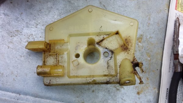

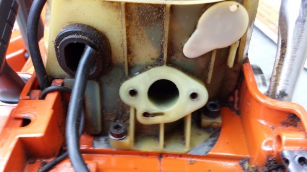

  4. HDRock
    17,262
    60,487

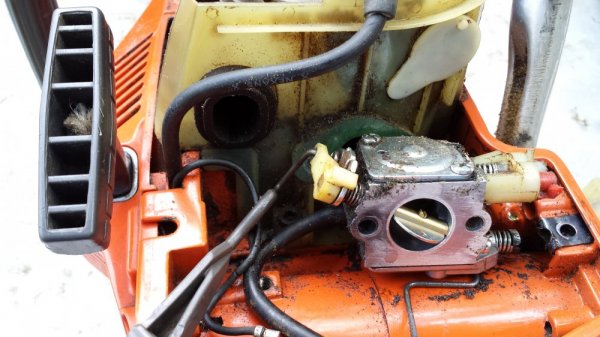

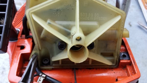

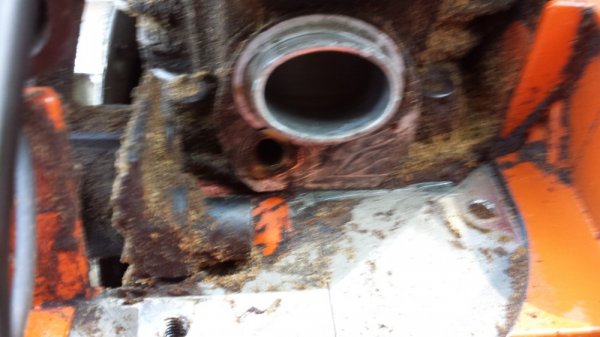

    More pics
    20140809_144633.jpg 20140809_144833.jpg 20140809_145001.jpg 20140809_145054.jpg 20140809_145135.jpg 20140809_145555.jpg

    When I put mine back together, I put some Anaerobic silicone (Dirko, CNH Gasket Maker, Yamabond, etc) Just a small amount on the inside and outside of impulse grommet, and a small amount on the inside, of both sides of the intake boot. Probably not needed when new, but an old impulse grommet that loose will cause a leak.
    With that said, it sounds like the intake partition may have been loose before disassembly? And your take down and rebuild may have snagged something up? Just a guess.. :)
    And fuel always helps a saw ;) lol Happens to everyone.

    the screws didn't seem loose but when I put it back on I pushed it in tight then tighten the screws down.
    I will order a new impulse grommet

    some of the pics I took just so I could be sure and put it back together right cuz of CRS :)

    Good thing I did ,had to look at a pic to get the throttle link on right
