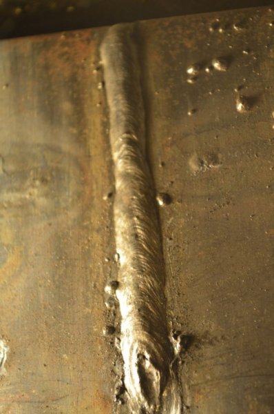

    I had a chance to burn a few more rods. Tried some 7018 but it wasn't that much easier for me so I figured I'd stick with the 6013 while I work on my technique. I lowered the amps and that made things a lot more controllable.
    Here is the latest. (it's hard to get a good pic and things look a lot better in person ;))
    What do you do at the end of the bead to avoid the ugly crater?
    6013, 3/32 55 amps

    Nice bead width, Are you having trouble with long arcing? ….. also make sure your cables are not coiled "at all" you shouldn't have those boooger splatters with those beads. your speed is good! Depending on your amps, stop for a half second more when you want to stop your weld and that "may" eleviate your crater. Break you arc quick also, lift your rod straight up. Your getting some arc fluctuation, are you running on DC or AC?

    Magnetic amperage fluctuation:eek::confused:…. Basicly this, having your cables coiled is like having an electromagnet situation, "4th grade science" but it throws off power in a crazy way! if your leads are on cement, high humidity, lots of metal near, and high water table. Yes K-mart shoppers, I have studied this! Try this experiment…. take you leads, coil them up and have someone start welding, through some small nails, ball bearings what have you in the center of the coil and watch what happens:cool:.

    Well, Lets say you want to have a consistant 100 amps while you weld. With magnetic issues, your ampreage will be sparatic +- depending on the amount of coils, temprature, and other variables, you could lose 10 to 20 amps easely. Basically your amps will fluctuate and you won't have a constant flow of current without some kind of disruption. The best way to have your welding leads are in a straight line to your work. "NOW" we all know that is nearly impossible in most circumstances, but if you fake them out so they don't cross over one another you will produce "MUCH" better welds.

    The leads were coiled, on cement, next to a bunch of metal tool chests and there is a high water table under the garage :( Didn't realize all that would have an effect.
    I've been running DCEP. Been trying to keep a tighter arc; some of the splatter on the top right is from an earlier bead attempt. What do you see in the bead to say arc fluctation?

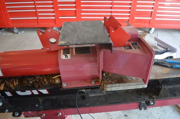

    I want to move the hydraulic valve to the top of the cylinder on my log splitter so I can use it from either side. If I weld this as pictured will it hold up (assuming a good weld and proper prep) or does it need more support?? The carpenter in me wants to put a support 'post' under the the left side of the plate.
  20. WeldrDave
    9,950
    54,210
    That material looks to be 1/8"?? Maybe 3/16….. It may vibrate a little but your fine! :D
