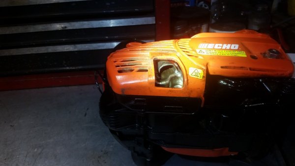

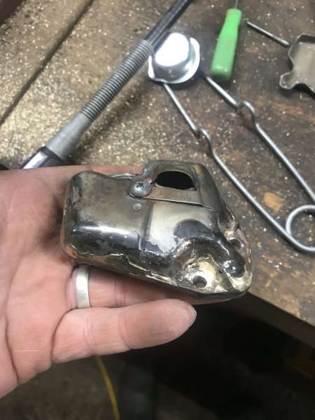

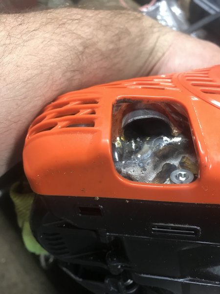

    I got my 2511 around the same time Scotty Overkill did and I never had the pleasure to cut with it in stock form! Somehow it came home landed on the bench and the muffler fell off:whistle:
    Tossed the center cat and baffle, cleaned things up then had a heck of a time brazing back together, hence the messy job. 70F85BAF-02D1-4D27-95CF-4208724C80E3.jpeg Opened the outlet and added a little pipe/deflector. DECFDEA0-31F2-4CB1-B6C7-E964F31C730D.jpeg

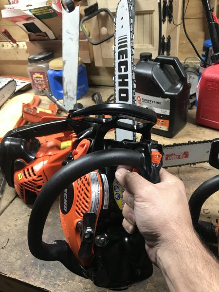

    Another thing I found was there was no spike on the saw so I snagged one from my dealer. 5F751393-F22B-487C-B431-9DEB6946E8BE.jpeg

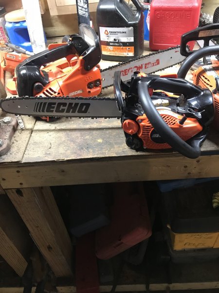

    I’ve been running the 14” 3/8 lp .050 set up that came on the saw and it cuts ok. 4D74A7A5-9C4B-4F4A-87F3-2AD5B9C41D94.jpeg 2DF78F9D-76B9-43BE-9085-60421A174757.jpeg Although it chatters like crazy!!! So recently I picked up the stuffs to do the 1/4” conversion.... stay tuned! :binoculars:

    I opted to do a CAT "bypass" instead of opening the muffler all the way, just to make it a quick and easy job.....made an angled chute deflector and the exhaust now goes out of the opening at the bottom of the cover....

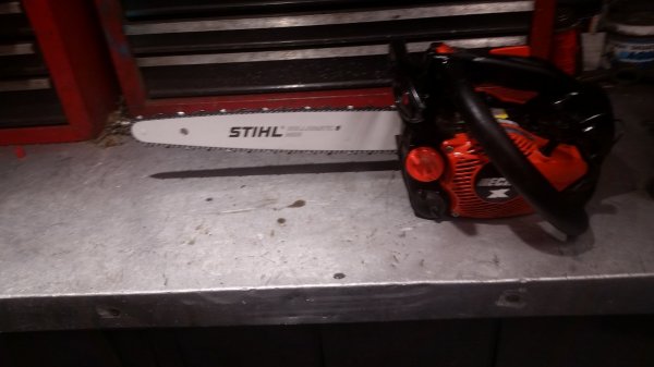

    Here's a short video of the saw running the 1/4-.043 Stihl carving bar and chain, notice there is no chatter at all in the cut, and for a small saw, it does quite well. It's become my favorite climbing saw, and I will be buying/modding another this coming winter....

    what is the advantage of the Stihl carving bar vs. Echo stock bar?
  9. Scotty Overkill
    9,775
    66,312
    On the 1/4 pitch chain, the cutters are closer to each other in series than on the 3/8 pitch....therefore, the saw has less "chatter" in the cut, and is much smoother in the cut.
    This new narrow kerf .043 1/4 pitch chain is pretty awesome for a climbing saw. That little echo is like a filet knife in the tree

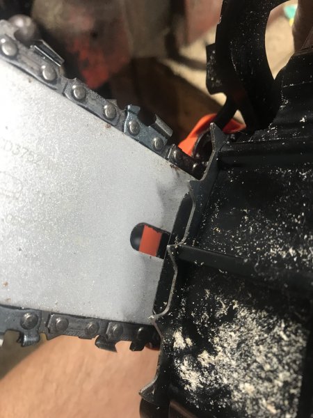

    Scotty Overkill can you post a pic of the tail of that bar? I just got mine and want to see what you did to get yours to fit up and oil.?
    blacksmith and Barcroftb like this.
  13. Scotty Overkill
    9,775
    66,312
    I'm in for the night, I'll have to take the bar off the saw and get some pics when I get a chance.
    I welded the factory Stihl oiler holes shut first putting a piece of copper into the drive slot of the bar, and re-drilled new tensioner holes that matched the echo. Then, carefully drilled down from the bar slot to the tensioning holes, because that's where the Echo oil channels from.
