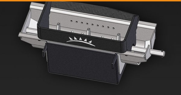

    I have contacted Enviro on the loose pellet getting into the ash pan deal. never got a reply. Brokenwing, I'd contact a rep and give em heck!
    The fix is to contain the pellets with added wings on the burnpot liner or fingers on the burnpot fire grate. It keeps the loose pellet in the liner on initial fill. Also makes the start up less smokey IMHO.
    I took the idea from the warmland PS45 stove.
    It has wings on the burnpot liner and fingers that extend into the liner from the burn grate. I opted for the fingers from the burn grate. I welded 4 steel extensions on to the burn grate that extend into the liner. Unfortunately they didn't last and eroded off due to heat and salts in the pellets. Next try was 2 plates that bolt to the burn grate and are made of SS. Here is my initial print(see PDF). Some trimming is required to complete the install. So far works excellent! The SS hasn't corroded in 3 seasons. Hope it helps.
