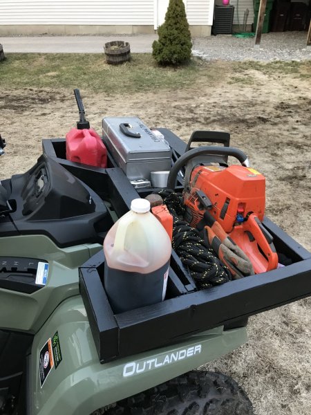

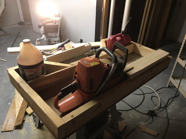

    Front tray build, this is so much fun!!!!! My ultimate wood machine lol. I had to put that cut in the top of the bar holder cuz i couldnt get the saw in (oops) turns out it will be a nice little holder when the bar rests on top and sits in that groove for sharpening. 68ABC203-8F70-49A7-8C84-F3433EABCB88.jpeg 56D1E535-BF82-4480-AD54-F042C177B3D4.jpeg

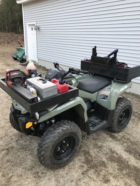

    Front tray is on, I sprayed both trays with rubber under coating after i painted them, i really like the setup. Took a ride with my little guy to my sisters down the road to show my Dad the new front tray. He’s retired and has a 2000 polaris 6 wheeler, he says well when are we gettin some wood. Him and my mom built an apartment in her basement and huge garage at my sisters for all Dads toys, they live less than a quarter mile away and have 30 acres. Good times ahead with the new wheels!!!! 6E8FD565-06E0-4EA1-9AA0-3329D05D41D9.jpeg 7D673FB5-2B0E-4DC7-9DC7-4503DFF84FF9.jpeg

    That Is a GREAT setup !!!! You will really enjoy having your saw mounted up front like that ! That is where I pack mine most of the time.

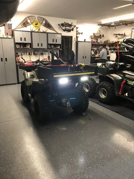

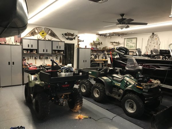

    Workin in Dads garage, added rear led lights and a quick reference ruler for firewood sizing. I cant stop!!!! 57D8497E-6A5A-4F2B-81AD-1AA4F48D4205.jpeg 9325DE9C-189A-491E-A825-B7131E02F5E0.jpeg 9BBEF1AE-41F3-405B-8496-5F5174BD6900.jpeg

    That garage is too clean. ;)
    Great idea about the rear LED lights.

    I know right its brand new, when he told me to drive over and do the lights there while he was waxing the boat i said i feel like i dont want to make s mess there. I like the lights, will also come in handy guttin a deer at night

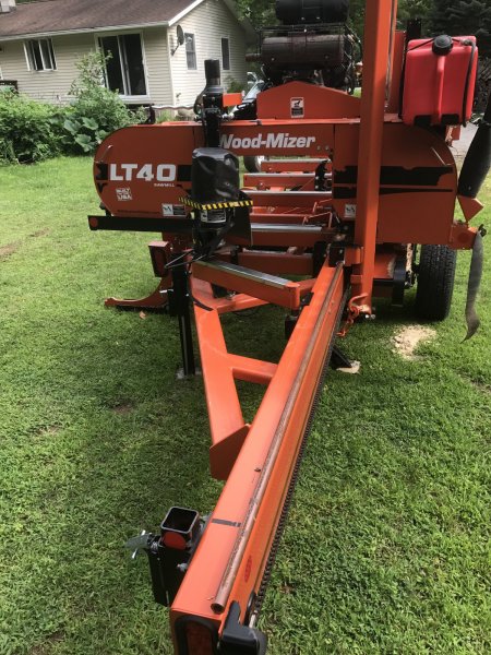

    Shawn; would you have a pic or any info on the Debarker you mentioned ? I've long figured that debarking is one of the most important things for milling .
    Nothing worse than being almost through a long cut with my Alaska mill and hit a little rock hid in the bark.
    It's amazing how such small rocks can ruin having a fun time cutting.
    Not being able to easily debark logs is the biggest reason I never got a band mill.

    I guess this is the best pic I have of it. It’s the motor ahead of the blade with the yellow/black caution stripes. The motor turns about a 6-8” carbide tipped saw blade that cuts a shallow kerf right ahead of the band saw blade. The whole assembly is spring loaded to follow the contour of the log and I think there’s a separate servo motor that retracts it for once you’re down to a square cant. Paul said he gets 50-100% longer blade life compared to his old mill.
