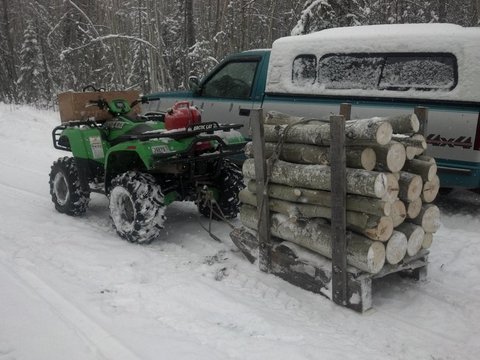

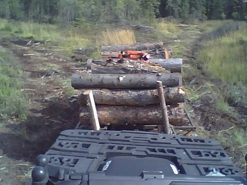

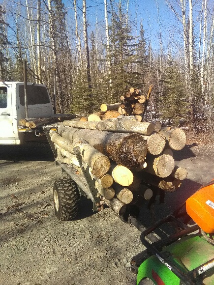

    PhotoMoto0018.jpg 1492643499016_PART_1492643498967.jpg photobucket-53705-1417744088557.jpg
    I've done a lot of 4 wheeler loggin.
    The thing with a 4 wheeler. Even a big one, is , you have to use them within their positive attributes. Power and nimbleness. They don't have loads of traction torque like a tractor does.
    So , I've found. Its best to give them a chance to work the way they were ment to. Trailers and sleds and log arches. Will allow a 4 wheeler do an amazing amount of good work. As much as your body can stand.
    If you build a dray or sled , you REALLY want to have PTEX runner skins on it . There is almost NEVER a time or condition where steel , aluminum or wood runners slide as easily as PTEX. The pictured sled has only hauled 30 some cord on it so far. It has PTEX runner skins on it.

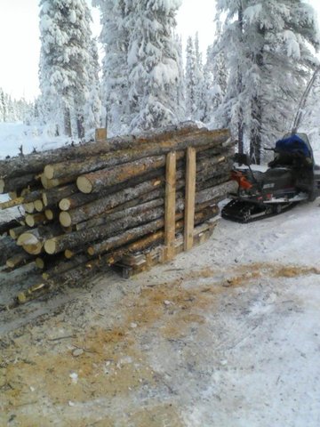

    This sled has hauled more that 140 cord on it . Runners are skinned with PTEX.
    And these are all real cords . Not 1/3rd cords.

    How did you attach the PTEX to the runners?

    I used a countersink bit in my screw gun and predrilled . then used 3" coated deck screws to attach them.
    On the low runner, most used sled the trailing ends wore and tore out from the wood at around the 100 cord mark. Considering I have less than $80.00 iirc in that sled. I sure can't complain. Plus the material I used is only 3/8" thick.

    When the snow melts enough so I can find the sleds. One is still out in the woods. I'll take a few pics and post them.
    Might be several weeks for that much melting to take place.
    It's not too tricky. Just rip some strips on a table saw or with a worm drive. Start at the runner tip and start screwing off.;-) IIRC I stagered them at around 8" oc.
