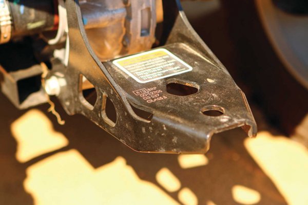

    Does the outlander still have this hitch on it? 2015.can-am.outlander-l450.close-up.hitch_.jpg
    If so just have a piece of 3/8" steel with 2 holes ( one for the hitch ball, and one for the ill concieved clevis hole. Use the ball hitch to sandwich it in between and also attach a bolt and nut ( put the bolt in from the top - clearance). Just make it barely longer than the hitch forward already, so there's less chance of clearance issues if the ATV is faced downhill, and the trailer is in a flat.
    My buddy and I made up a similar clevis pin hitch on my bayou, because there was no clevis pin hole, without removing the hitch ball. Pita. Fixed with some minor engineering.
    See those bent down ears? Those things won't allow you to turn with a clevis pin hitch like most yard carts, rollers and such.

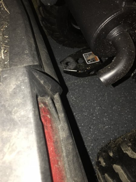

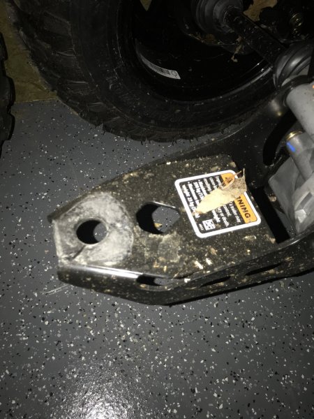

    90E97384-34B3-4EF3-822F-57F9372021F3.jpeg EC91C137-13CF-4D35-BEFF-4E7056B2D620.jpeg

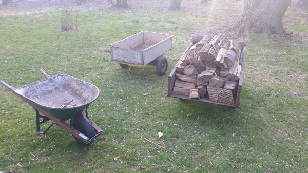

    The view from the back door...

    Yep. Same as before. Nothing that can't be fabbed up in short order.
    This is where practical engineering isn't done. It looks great on the computer screen, and even when it's made in real life. But go to hook up that yard cart and you'll quikly see the issue.

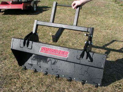

    My dad bought a swisher front bucket for the sportsman. They really are not that good, those buckets. Mulch would probably be the most to use it for.

    Those buckets are expensive, but its possible we would part with ours. Wish you were closer, because they are heavy and would cost a bit to get from WI to NH.
    If you're interested, lmk. It just sits around here.

    Unless you're scraping mulch from a mulch pile recently dumped on asphalt you really need a tooth bar on the bucket. Cutting into mulch with a straight edge can get ya spinning tires and making a mess real quick. I found a good hay-style tined fork and a dump trailer and/or wheelbarrow was faster in many instances. Especially if it's just a few square yards.
