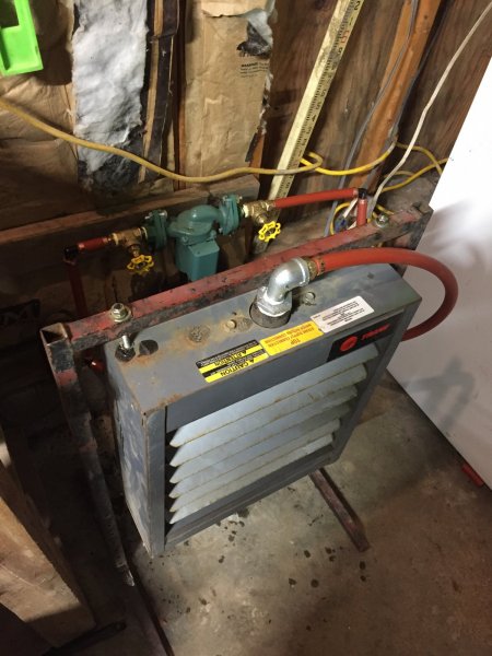

    Hello all, I recently hooked up a Trane steam/ water heater in my garage. I don’t run it all of the time, just when I am working out there. The problem I am having is it just doesn’t put out much heat at all, the inlet and outlet pipes are plenty hot, and some spots in the fins are hot, but others are cold to the touch. I installed a bleeder on the top(return) fitting, and feel confident I have all the air bled out. Anyone have any similar experience with this?

    Trane "steam/water" heater? I have considerable expertise in hydronic heating systems and I have no clue what you are trying to describe.
    Are you running a steam boiler or a hot water boiler?
    The heating zone you're talking about sounds like a hot water loop into a forced air coil. Is this correct?
    Pictures are worth a thousand words.

    Yes, sorry about that, a hot water boiler, the heater shows it can be used for either steam or hot water. Have pump pulling from boiler to garage, (approx 30’) heater is just past pump, water returns to boiler after leaving heater, picture included does not show bleeder valve I just installed.
