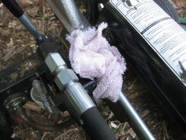

    Splitter developed a new leak. I noticed hoses getting wet. Took a rag and wrapped connection and it got worse. Is this a simple tighten the fitting or is there a "washer" inside that needs replacement.
    Splitter was bought June of last year. What happens if fluid gets too low? Is this detrimental to the machine? IMG_1650.JPG Makes me want to buy an electric flywheel splitter.

    Low is detrimental. Most likely it will shut off at that point and you'll be scratching your head wondering why because it has fuel and engine oil.

    That’s just a flared line. Put a wrench on it and see if the nut moves. Could be as simple as that.

    This ^ ^ ^...even if that is an oring type flange (doubtful) it may still just be loose, or worse case scenario, need a new oring.
    And if its coming from the pipe threads, just remove the fitting, clean the treads up, install a quality hydraulic pipe dope (I prefer the kinds that harden) and reinstall the fitting.
    Whatever you do, don't let it run out of oil...that could trash your pump (although they are not super expensive though either) but, it would take a pretty good leak for a long time for the pump to suck air...and you would have to run the pump dry (sucking air) for quite a while to trash it...which I have no idea why someone would do that, cuz the splitter would not be working at the point.

    Use a backup wrench. It should be good and snug. I had one go bad on mine a while back. It was cracked under the nut. Replaced with copper and it lasted almost two year I replaced it with a hydraulic hose. All good.

    Put an adjustable wrench to that fitting. Loosened then tightened it. Wrapped a clean fresh rag around it and fired it up. Ran for an hour or so until it ran out of gas. Checked a couple times and at the end and did not see any oil on the rag. Thanks for your input FHC! Much appreciated! :salute:
    Is it common for fitting to loosen on a hydro? Are minor drips kinda the norm? IMG_1668.JPG

    Leaking where the steel tube goes into the 90 degree fitting?
    That should be a flare fitting where the tube has a flare under the nut. Try loosening the nut and retighten it.
    I have seen some where the tube cracks in that area most likely caused by vibration.

    Exactly what i ended up doing. When i tried tightening (tight quarters) it didnt seem to move so i did the former and walla...no leak. Ill keep the rag on it and check it from time to time.
