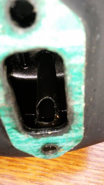

    I think Czed touched on one of the most important points when he said about looking at the exhaust and intake ports on the Hutzl/FarmerTec cylinders for sharp edges. Use a Dremel with a small burr and soften up any sharp edges around those ports, then do a good clean out of the cylinder.
    I learned the hard way on a Stihl 034 build I did last summer using a FarmerTec P/C, luckily all I ended up doing was breaking the rings......

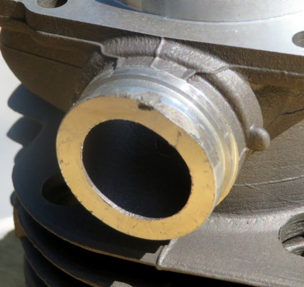

    15304608074081128164685.jpg I've been cutting 1/2 inch from the bolt tubes on each side.
    To allow more flow
    Noise isn't much louder at all
    And i can tell a difference when cutting.
    Just on the 5.00 china mufflers
    Oem one's get deflectors lol

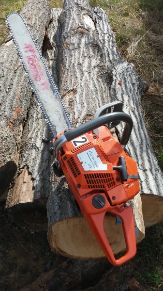

    Running a bigbore with a 28 inch bar
    Dropping poplar 20181012_160124.jpg and oak
    It's been a very good running falling saw.
    I've got under 300.00 in it
    Well worth it to me.
