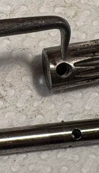

    IMG_0712.jpeg If there is supposed to be a screw in the hole indicated by the 90* pick then we are missing a screw . . .
    brenndatomu and eatonpcat like this.

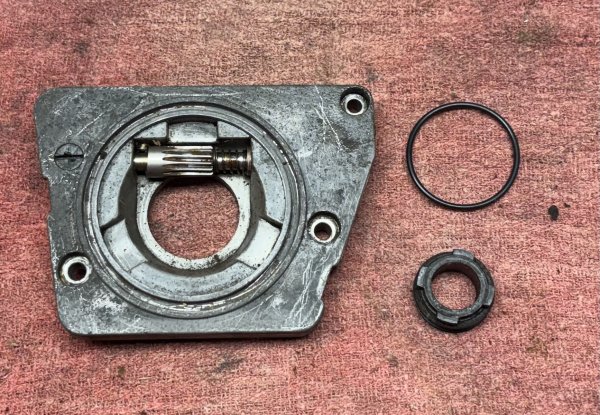

    I'm almost certain I have an entire spare pump for that saw kicking around. I can confirm tomorrow. If you want it, it's yours for the price of shipping. It's a good idea to change that crank seal while it's apart though. I might have one of those too...

    Personally I wouldn’t mess with the Chinese pumps. I’d rather not have to fix it again if it fails, and would trust a 40 year old OEM over a brand new Chinese knockoff.
    Here’s what I have if you’re at all interested. A spare pump, a spare plastic gear, and a brand new o-ring for behind the pump. All you would need to buy is a crank seal (a set of 2 if you feel like changing the one on the flywheel side too)
