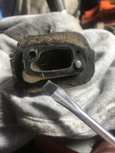

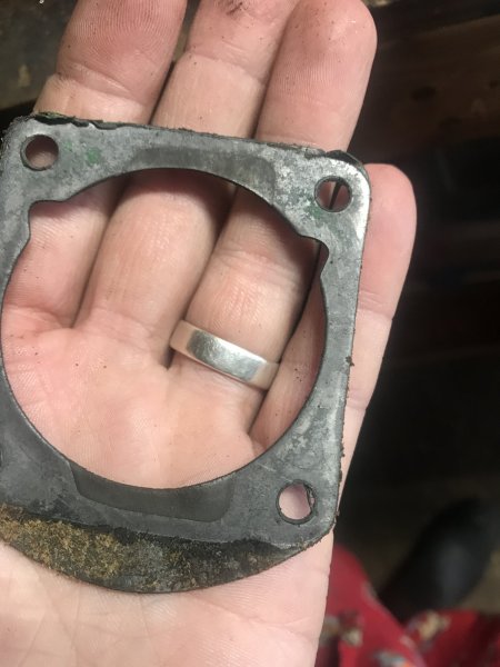

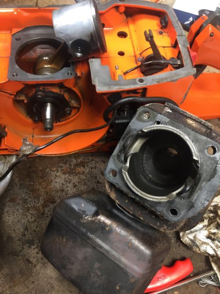

    67B13595-9343-4B23-A0B3-387797F30F1A.jpeg This a question about the transfers.
    I’ve come across impulse ports being mismatched on aftermarket stuff.
    This is similar.
    Notice the case stain and then notice these semi-closed port transfers on the cylinder, 50% of which is cut off by the gasket. And that’s ok, because the crank case does it too. I’m pretty sure I’ve got a mis match here that someone tried to make right after a toasted top.
    Can anyone tell me what the original intent was for this cylinder?

    It’s just a detuned open port cylinder made to fit on a saw that was designed for a full extension. Gotta remember, it started out as a 162SE, which was a closed port side fed cylinder with a full extension like a 262, 394, 2100, etc. Husky put it in the ranch class with an open port cylinder on it and took off the XP designation probably to gain a share in the farm/ranch designation with a lower price point.
    If you were to lay the gasket on top of the case, it fits perfectly

    You can see the cylinder transfer outlines on the gasket here too. 6B4CFE3E-F499-405F-941B-F332B16C990F.jpeg

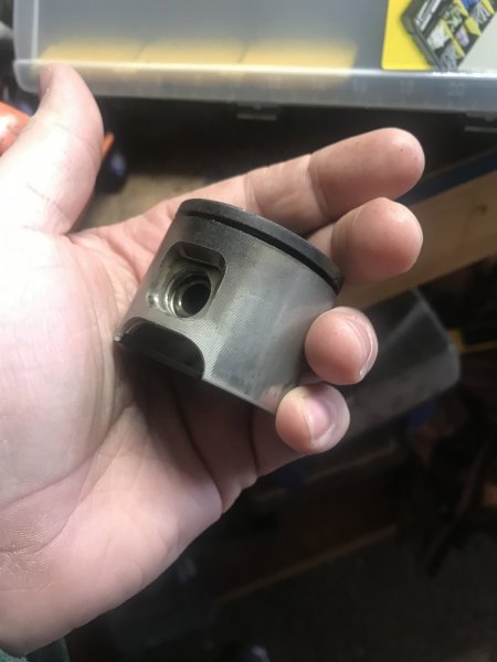

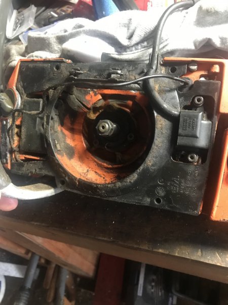

    Had a shred of aluminum got sandwiched in the intake gasket between the cylinder and intake. 2D87E94F-8F23-45A4-B2FE-AADAA82476A2.jpeg Two coils? A10CA613-B8CF-4247-BEAB-E69C76AFDCA6.jpeg

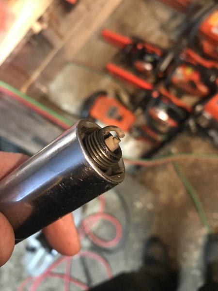

    a little better? No load around 12,6 seems to be much better! Plug looks nice brown color.
