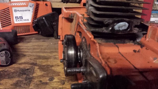

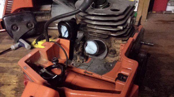

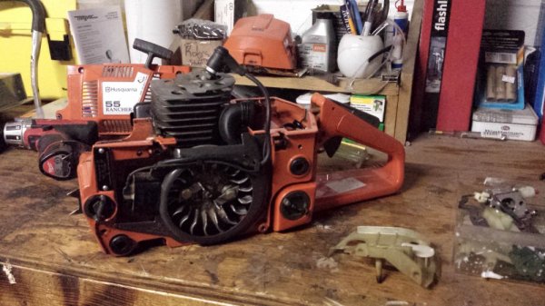

    Little update on my Minty 55 Rancher ;)
    It had a stripped intake partition (knew that when I bought it). So I took it apart in anticipation of the part arriving. .
    Then, I figured I should clean it. Then I figured the base gasket should come off, then I figured..... (metal shavings).
    It already had a decent Muff mod. I opened it up a little more and now it's time to clean and update the power a little :thumbs:

    Dex, what are you doing as far as porting? Just cleaning up, widening? Changing port timing at all?

    I'm not a builder and don't want to learn to read a degree wheel.
    All I am doing is widening the intake and exhaust (putting decent bevel) opening up the transfers (this is not the desirable closed port, it's an open port) and deleting base gasket. Add that with my muff mod a new air filter (and partition) and it should run pretty good. :)

    All done with a Dremel.. ;) and several different tungsten and carbide cutting bits.

    Oh and a Caber ring to top it all off :)
