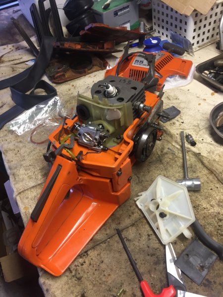

    892A31A1-EB64-4D98-8C81-0966DACF8EDF.jpeg 9C9A9A0B-81B9-4F67-BBCE-DB7E4596A3C1.jpeg BA3888DA-3ADC-422D-A4E9-4977CF09FBAF.jpeg C626365C-B093-4221-A6D2-029EA532C16B.jpeg Pulled another 55 out of the bucket today.
    Leak check was ok but not 100% but pretty good. I only sprayed the top and could hear a little hiss so attributed to the boot.
    Cleaned it up, replaced the fuel filter, the intake boot with a Farmtech, impulse grommet and spark plug. I used a carb that now I question its origin.
    Got it built and started but it won’t run. Dies pretty quick at idle.
    And it won’t start without choke, at all.
    Looks to have a brand new p/c, but I don’t know the make.
    Only has 135 psi.
    Gonna figure out the carb and replace boot with OEM and get a new bulkhead. Probably check squish and pull the jug to see what going on there.

    Looking for some suggestions. After it warms up a little, it will die when I hit the throttle.
    Did a full leak check and it’s tight. The only place it could be leaking now is at the carb gasket, not included in the leak check.
    I swapped carburetor to one I know works, same problem.
    I can get it to run better when I turn the H adjuster 3 + turns out. But that’s not a good solution.
    I still haven’t pulled the jug yet. I’m going to.
    Think a leak develops when it’s warm that isn’t seen on a cold leak check?

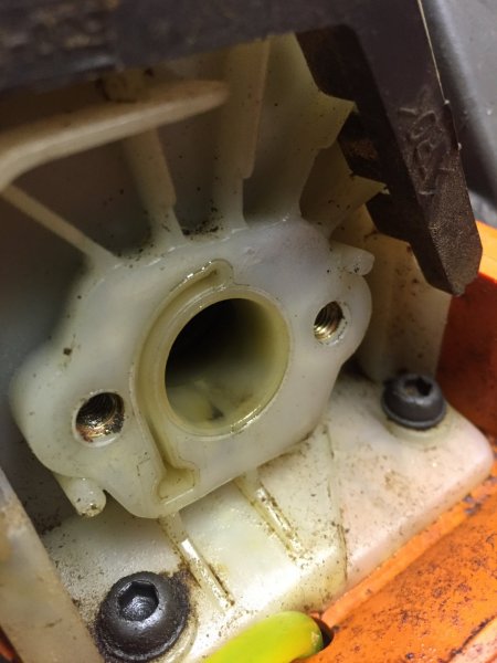

    564300BE-5465-4AD0-978C-2CF80E9C491D.jpeg C4428612-1E6D-4554-856E-8E204FD4AC43.jpeg
    If this isn’t the issue I’ll be surprised. I checked this impulse channel looking down at the case. I checked it the other way this morning.
    Gasket covers the impulse on the cylinder but not on the case.
    Found some good info on AS on this.
    Going to open that up to get some daylight and see how it goes.

    Is that an oops in manufacturing for those gaskets or is there a couple different styles?
    M2theB likes this.
  20. M2theB
    M2theB
    Jan 13, 2017
    3,004
    19,226
    Central Massachusetts
    It’s a manufacture defect with the cylinder. The impulse hole in the cylinder is out board of the channel in the case. So the never match up.
    I guess running it cold there was a enough slop to let the impulse make its way through to the carb. But the hotter it got, the tighter it all got and it started the problem.
    I took the Dremel and walked the hole closer to the cylinder, using the gasket as the guide. See the pic above.
    World of difference. I reset the carb to 1.25 on the H and L before starting it and it was running super rich on H. Now down to about 1.
