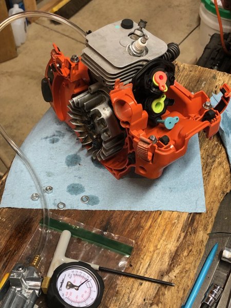

    I have a metal plate that bolts over the muffler opening with rubber inner tube piece that seals it. I have a hole in that setup that one of the skinny tapered plastic probes from the mityvac kit just friction fits into. Can't see that in the pic. The chartreuse and light blue plugs came in the mityvac kit too. I'm glad I purchased the whole kit when I got it cuz those rubber plugs sure come in handy. I did blow one of the chartreuse plugs out of the intake manifold when pressure testing it. You may be able to get a variety of rubber stoppers from the hardware store. Golf tees are handy to have around also.

    I want to click a "love" button for the comment that you got your saw problem figured out! Way to go! I have a threaded piece with o'ring that replaces the spark plug and has a nipple on it for the mityvac hose to connect to. I will look at the hardware store for a couple rubber plugs. I like your set up. I purchased a cheaper version mityvac many years ago just for one person brake bleeding.

    I have similar. I broke apart a plug and JB Weld’d a fitting to it so I can attach MightyVac. Works great.

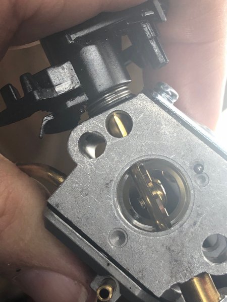

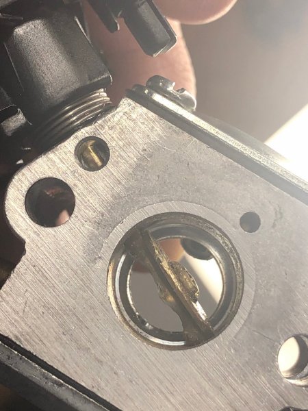

    I put it in some wood and it runs pretty good.
    I did some practicing on the carb with the bad nozzle this evening. I'll do the good one when I get some more time and see if that helps out any. By the looks of the more open space through the carb I would think it should make a little difference.
    Before trimming the stuff out of the way.
    with a little trim!!!
    Yeah, I know, it isn't the thing of beauty that I would hope for, but it looks way more open through there now... Hoping to get a little better with a couple more before I open up the carb on my G288 also...
