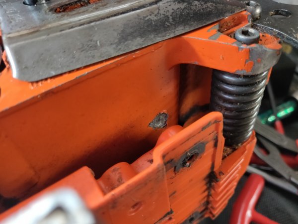

    Got this saw up and running with the Meteor piston and cylinder. Here's the list of stuff I did to it:
    1 New piston, rings, wrist pin, wrist clips
    2 New cylinder, cylinder gasket, and muffler gasket
    3 Plugged decomp
    4 New air filter (aftermarket)
    5 New Oregon spark plug (came with Piston/Cylinder kit)
    6 New 3/8" 7-tooth OEM rim sprocket
    7 Idled for an entire tank to break in
    8 OEM carb rebuild kit
    9 Carb adjustment
    10 New fuel filter (oem husky)
    11 Took intake manifold from donor saw as this one was ripped (oem)
    12 Filled fuel with VP 50:1 and filled bar oil
    13 Lubed clutch needle bearing w/ lithium grease
    14 Loctite on chain brake cover, handlebar, muffler, and cylinder screws.
    2nd pic shows some damage I think as a result of someone using a long coarse threaded screw there instead of a shorter one.
    Will do some test cuts and some carb adjustments tomorrow.
