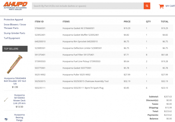

    Here are the part numbers and the cost.

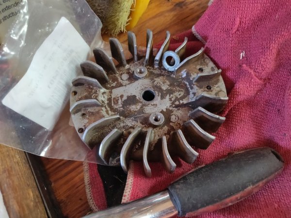

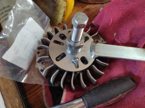

    The husky flywheel removal tool worked great. That sucker was on there super tight and popped pretty damm loud when it came off.

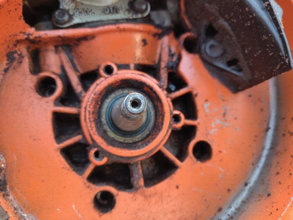

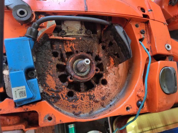

    The case is definitely leaking at the case gasket and while I was able to turn the case screws a little it didn't help stop the leak. It will need a new gasket and some rtv. Setting this saw aside to see if I can get others working faster.
