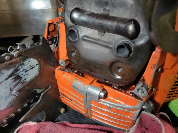

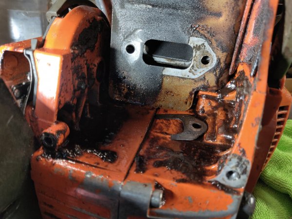

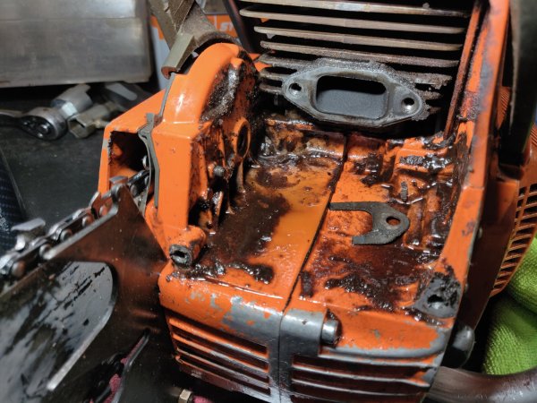

    I tried starting up the 372xp that was leaking oil. I replaced the oil pickup line because the old one was flopping around even though it was supposed to be held in place by the oil pump. I'm not convinced that's the problem but I did have to take it all apart to clean out all the gunk or else it's impossible to see where the oil is coming out of.
    The saw wouldn't idle so I'll have to turn up the idle screw. There was a whole bunch of old oil I didn't clean out under the muffler which is a weird spot. I waited for it to cool, took off the muffler, and one of the bolts for the muffler wasn't even on tight and the gasket was only half there! So I'll order a new gasket for that and I left it on my bench titled to see if I see a puddle of oil in there. If I don't, I think the culprit must be the oil adjustment screw or the delivery line where it connects to the oil pump or the pump itself. I can try using some RTV gasket sealer but maybe I'll just swap out the oiler with one of the donor saws instead. I think I saw some oil coming out of the oil adjustment screw but that wouldn't explain it showing up under the muffler.
    Fresh yellow oil was definitely getting to the bar as I tested it out first without the bar and could see it dribbling out from the bass delivery line. I had drained out the old red bar oil so the fact that fresh yellow oil was also showing up underneath the muffler is disconcerting. I think maybe the case gaskets are leaking? Not sure at this point.
    I think this is only happening when the saw is running because when I set it aside the last few days there was not a drop of oil anywhere.

  14. BuckthornBonnie
    BuckthornBonnie
    974
    3,199
    Penn Yan, NY
    Case gasket? Maybe try to tighten the case screws and see if one rattled loose. Check for cracks around everything and run it without a bar/chain for a bit and try to isolate the leaks. Throwing parts at saws is tempting but adds up fast.
    High use saws typically have many things wrong with them at once.
  15. LordOfTheFlies
    LordOfTheFlies
    Apr 5, 2019
    2,519
    12,097
    NY
    Front screw was a tiny bit loose. I will check the others after the overnight test. I haven't ordered anything yet. My goal was to clean it up so that I could try and see where the heck it was leaking from. Have you ever seen it leak under the muffler like that??

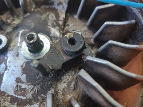

    I'm pretty sure the 372xp is leaking from the case gasket. I saw fresh yellow oil this morning when I checked it. Not a ton but enough. My suspicion is that the case bolts are loose given that one muffler bolt and the exposed case bolt was loose. I shaved off the excess gasket and wiped it clean with a rag and brake cleaner. Waiting for the flywheel removal tool to arrive. I tried using the $20 HarborFreight air hammer and alas it did not work.
    Then I did something stupid and whacked the crankshaft having thought I had screwed in the nut......but of course I hadn't and one whack is all it took to see the nut all crooked and the threads slightly damaged. Luckily I have a m8 x 1.0 tap and die and was able to fix it with just hand pressure on the shaft as the holder for the die was way too big to fit in there. I learned my lesson on how to remove and reinstall the Husky spring loaded pawls for the flywheel as well. I did end up using the machinist vise for the nut and the holder for the tap. Cleaned it out no problems. Dodged a bullet there!

  20. BuckthornBonnie
    BuckthornBonnie
    974
    3,199
    Penn Yan, NY
    I broke the crankshaft of a 372 (my first pro Husky experience) when tightening the fw nut. It happens…
