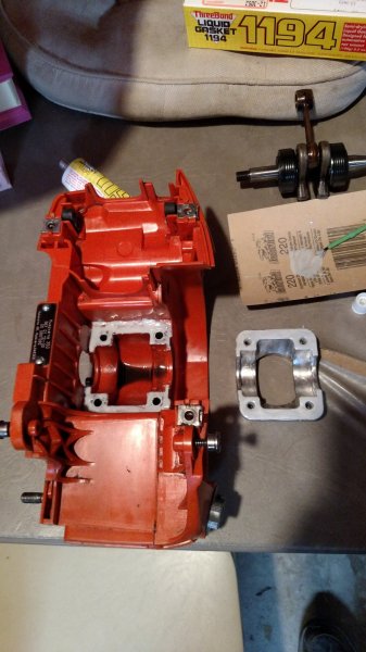

    Anybody have a clear answer for this dilema ?? Are you suppose to but sealer in the bearing seal grooves ? For me..this was a pretty tight fit....and didn't seem to be any sealant in those areas on the old parts.... IMG_20160126_131335862.jpg

    You dont have nothing to loose if you put a little sealer there , and dont forget METAL clamp to the intake

    So I just tore it back apart...and resealed everything....I should have just done it the first time. What a pain lol !

    i recently did two 345's and i did put a very thin coat on both top and bottom seal surfaces, whether thats right or wrong i guess ill find out haha.
