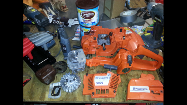

    Hey fuzz, really jogged my memory reading this. I did the same thing last winter with my old 350. Haven't ran it much since rebuild but plan to this spring.
    Here it is after disassembly/cleaning:
    cnice_37 and HoneyFuzz like this.

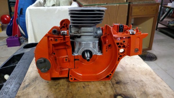

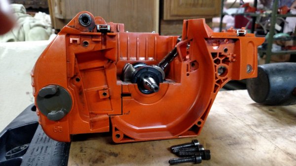

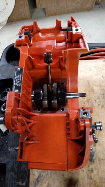

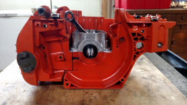

    So got a few parts in ......
    Started with new crank bearings and seals. The original bearings seem good....but...the new set wasn't expensive....so while its all apart....why not replace em. Cleaned up the crank a little...lubed the pee out of everything....put the new seals over the bearings....which is a tight fit lol ! So far..so good ! IMG_20160126_084315793.jpg IMG_20160126_085129635.jpg IMG_20160126_085408647.jpg IMG_20160126_085414672.jpg

    I debated whether or not to replace the crank seals on my 350 when I rebuilt it. Decided against. Not cost related, but read that they can be a pita. I noticed that I have an oil leak coming from behind the metal case cover on the drive side...gotta get that taken care of.
    HoneyFuzz likes this.

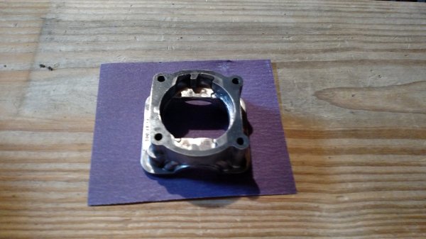

    So I was able to get a little more done today....first...as I have read and seen in vids....lightly sand the bottom of the riser on a flat surface...to smooth out any high spots ... IMG_20160126_130755599.jpg IMG_20160126_130927729.jpg
    Bright and Shiney !

    Did you put any sealant on the outer rubber coating of the bearing/seal?, to be honest, I'm not sure there should be or not, I've never had to tare down one of this series of saw that far.

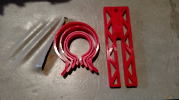

    So next step.....Three Bond on the cylinder...to heck with the base gasket lol.....lubed up everything really well....on goes the cylinder....thanks to my handy dandy beloved piston ring compressor kit ! IMG_20160126_133613236.jpg IMG_20160126_134457746.jpg IMG_20160126_135039044.jpg

    Northeast , Ohio
    I pondered this.....I decided not to....as the fit with the seals into the grooves of the riser and plastic holders took alot of effort on my part... So I figured it was good. I hope I made the right move.
    Also....there were no remnants of sealant in those grooves or on the seals from the factory.

    Did it look like it had any on the old ones when you took it apart?

    Nope .I edited my above post right as you asked that question lol ! We are on the same page buddy :)

    Definetly sealant on the flat matting surfaces. The stuff turned a whitish brown color over the years..hard to miss.
