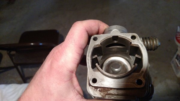

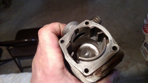

    Took about 10 minutes with 320 emery cloth ....and 0000 steel wool....looks like new ! So in looks like ill just get a 44mm Meteor piston kit for now probably ! Sorry for the crappy pic :). Maybe someone can add a bit on this. The piston and inside the cylinder both had like brownish black burn stains. Why is this ? And how do u clean inside the transfers ? Get all the gunk out. Open and closed ports... IMG_20160119_165546072.jpg IMG_20160119_165550781.jpg
    P.S..it's hard to take good pics of the inside of a cylinder lol !

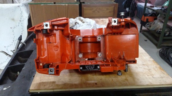

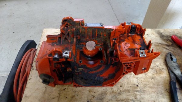

    In the middle of a dawn dish soap and hot water bath......I usually like simple green and frequent rinses on plastic...but im plum out :( IMG_20160120_135139693.jpg
    After alot of scrubin...compressed air...and good old fashioned rag time :) IMG_20160120_142610812.jpg
    Ordered up all the parts I should need for this. So hopefully more to come soon ;)
