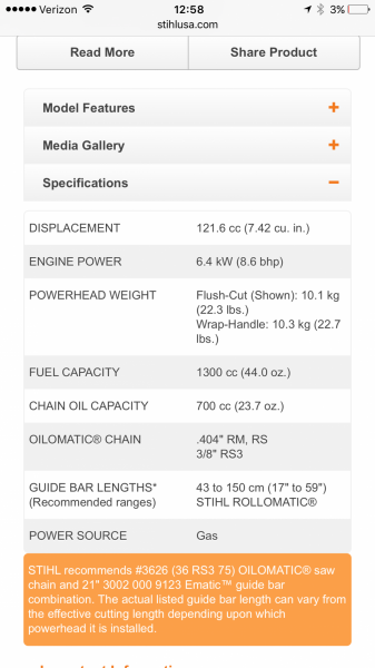

    Manufacturers recommended bar lengths can be quite entertaining. :popcorn:
    At one time Stihl recommended a 21" bar on the 088/MS880. :rofl: :lol:
    Get yourself a 90cc saw a don't look back. Yes, a good, high powered 70cc will do fine with 28"-32" bars but for stump work, I want the extra grunt for sure.
    Get a load of this!
