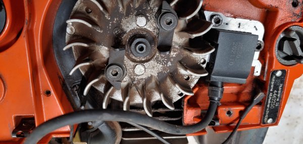

  4. T.Jeff Veal
    29,737
    190,960
    Picked up the saw Friday, cranks good. Put it in the case and inside my truck. Took it out this morning, gassed and oiled it up...
    Looks great, doesn't it...:whistle::whistle:
    Didn't know I needed to check it that close:doh::picard:
    Now, we have to drive 30 miles 1 way to get it right...:headbang::headbang:
    Shade tree at it's best...:thumbs::rofl: :lol: 0530220807.jpg

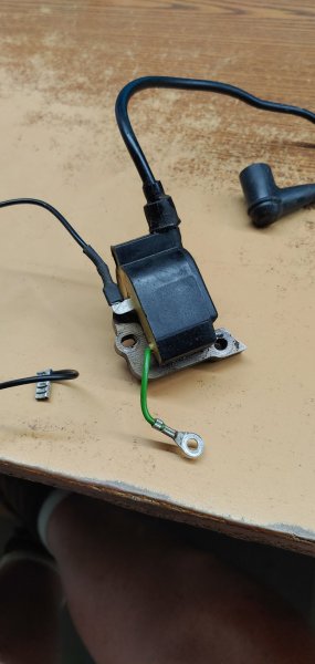

  13. T.Jeff Veal
    29,737
    190,960
    It runs good. I just wanted him to fix his mistake...:picard:
    He did, sort of. Cover is tight, but it now has 2 husky screws and 2 Stihl screws...
    I needed to get gas for the truck, mower, trimmers and splitter.
    The coil he put in doesn't have the ground wire, so kill switch don't work.
    A friend sent me a coil, I will put it on later. No worries, he won't see my :) again.

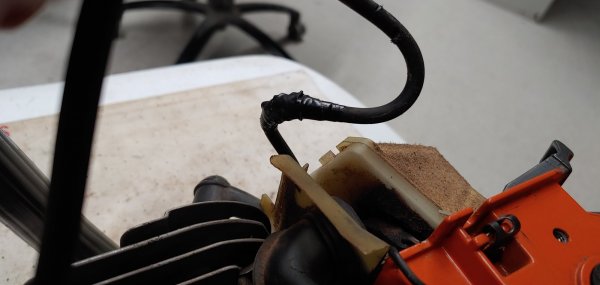

  17. T.Jeff Veal
    29,737
    190,960
    Decided to see what else he had done/ not done to the Husky. 0605222216_HDR.jpg
    The coil he put in doesn't have the ground wire, like this coil... 0605222306.jpg
    But the small wire was hanging loose behind the coil...:picard:...probably why the kill switch won't work...:whistle::whistle:...
    Then there is tape on the plug wire:headbang::headbang:
    Lesson learned....
  18. T.Jeff Veal
    29,737
    190,960
    Plugged wire on spade, finally got it to crank...:whistle::whistle:
    It's magic, the kill switch works now...:D:D:thumbs::thumbs:

    If he was repairing a coil wire that he noticed had a bit of damage from rubbage I'd be ok with that....but it's definitely not right to charge you for a "new" coil, not connect the kill wire to the switch, and tape up the damage.....He obviously just had that lying around that was taken out of another saw.
    That was a hack job holy moly. Glad the saw is working again! Good job fixing it!
