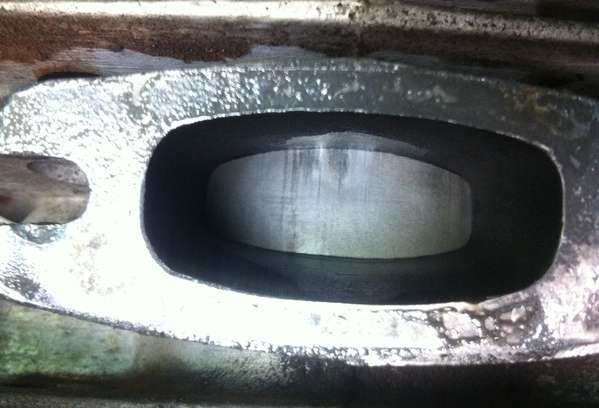

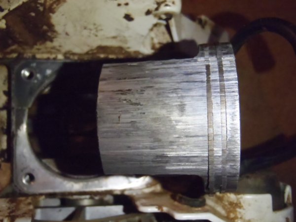

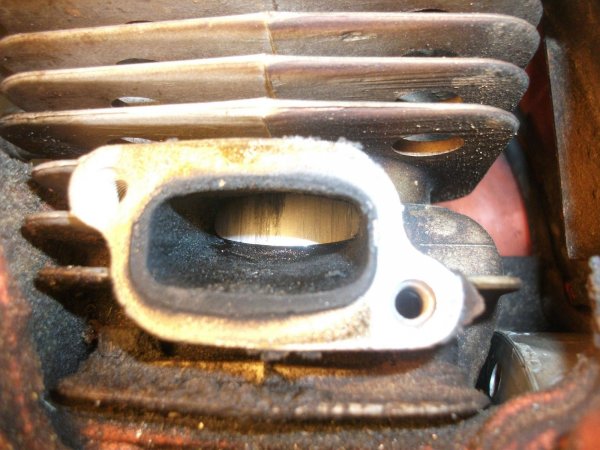

    Ok a quick qoogle search and I found some scoring or transfer pics. You don't really want to see this stuff. Not bad if just transfer on a high hour saw but I don't think you should see anything close to this wear. If you do walk away. Of course it gets way worse than this but there is no way the saw would be sold or running if it looked like you took a rasp to the piston.
    I could show you new pics but they will look just like that new Shiney metal with possible light machine marks visible depending on your eyes. But again what you don't want is that vertical transfer/scoring visible on the piston. It usually shows up on a piston before the cylinder walls. But when you take the muffler off rotate the saw till the piston becomes visible and then slowly drop it below the exhaust port and look at the cylinder walls. The exhaust side will scratch or wear first as it sees less fuel on it as well as has higher temps.

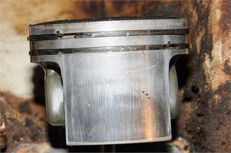

    Here's a pic of a bad piston on a 036 I rebuilt years ago.
    A good one will look oily and shiny and may have horizontal machine marks still on it. They should also let you fire the saw up and here it run. Thats the real proof. Idle shouldn't change if you tilt saw in different positions.
